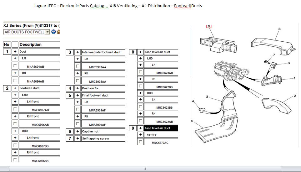

I just want to add some of the JEPC (Jaguar Electronic Parts Catalog) sections that pertain to the Heating and Air Conditioning information.
Here are 4 JPEC files that show:

The Footwell Air Ducts below give part numbers for both LHD (Left Hand Drive) and RHD (Right Hand Drive) Jaguars
Jim Lombardi

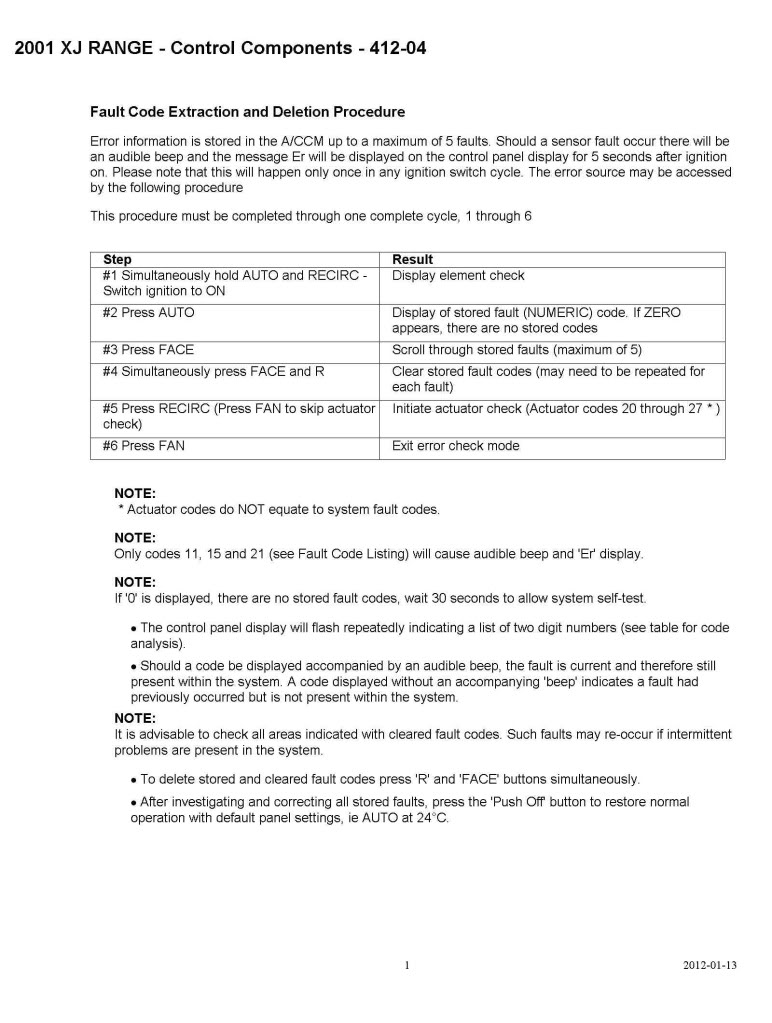

The Climate Control module also stores Fault Codes about the Heating & Air Conditioning components.
Here is a JPEG I made from the JTIS21 page on it:
The AUTO mentioned above is the button for Automatic control of the system.
The RECIRC is the button for the recirclation.
The FACE is the button to turn on the upper vents (pointing to the person's head).
The R is the button for the Rear defroster (Heated Rear Screen).
The FAN is the Fan Speed button.
Here are the images of the Climate Control buttons mentioned above:
The Climate Control Fault DTC are listed along with the diagnostic instructions information I extracted from the JTIS21 and put in this PDF file:
2001 XJ Climate Control Fault Codes.pdf
I noticed that I had a fault code 14 stored in the Climate Control module.
A fault code 14 is a water temperature input malfunction - possibly caused by the output from the instrument cluster module.
Apparently this is a leftover fault that was caused by the instrument cluster module we had to replace a month ago. The circuit board in the instrument cluster module was bad.
I cleared the code 14 using the information in the JPEG above.
Jim Lombardi

I'm losing a bit of the story here.... Are you saying that you cleared the "code 14," and that doing so made problem(s) go away, and now your heater works fine?

Default actuator test
Following the instructions for the actuator test below, a couple of questions:
Will the test repeatedly cycle itself until interrupted?
Mine appeared to do so, until I interrupted it with the fan button.
How do I interpret the results of the actuator test?
I did the procedure over again, only to check for codes, and there were no codes stored- it gave me "0".

I wouldn't have been able to sleep well if it hadn't been for your post. Got my er code cleared. Thought I was in for some real trouble but your post saved the day as it Did for hundreds if not thousands of others. Cheers.
