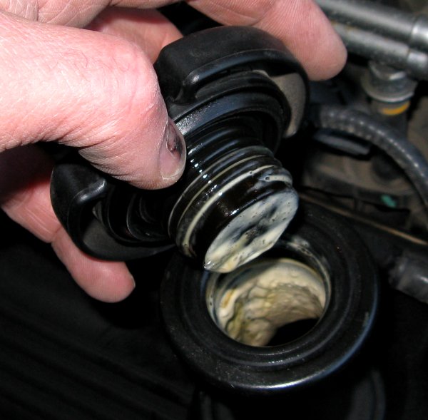

There are several factors that cause water to get into the engine oil, including leaking intake manifold gaskets, cracked engine castings and a blown head gasket. What I would do is look under the oil cap and on the oil cap do you see a brown oily sludge like milkshake? if so it is a blown head gasket

Ok yes I did that nothing it was clean. No smoking from the rear. The oil on the dipstick was much higher than normal fill.
