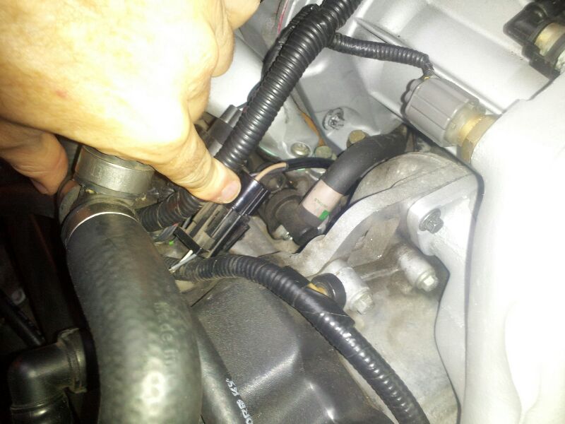

hey HAPPY TO HEAR YOU RESOLVED YOUR PROBLEM, i am now in he same mess, i just washed engine bay and of course p0332 code coming up.
ran her to warm up and waiting to see if heat dissipates water, and im gonna have to get water displacement electrical cleaner and clean up,
what connectors are the ones for the knock sensors on supercharged model? i see more than 15 there behind the throttle body, gonna have to go one at a time.
thanks for all help in advance!
James D.
James,
The knock sensors connect in front on each side, see attached photo. I just replaced mine while I had the super charger off.

awesome, yeah i just discovered it there under the part breather hose, i sprayed it down last night with electrical cleaner and plugged it back, went today plugged scan tool did not see any codes started her up, code p0332 came up after 2 mins of idling,
is it a good adea to run the engine with one disconnected till it heats up too see if without electricity to it it will help it dry out better, i sprayed moisture displacement down the engine to the area where this sensor is at, (center of supercarger and head. ) last night also, ill probably spray a little more electrical lubricant see if it helps a little. good luck to me!!! :S
