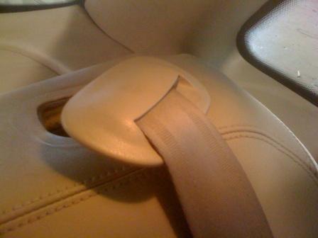

Thanks a lot!
I did it except I put a hairline crack in my rear deck attempting to remove it. I guess i didn't exercise enough care. Maybe i should have removed the seatbelt reals before attempting to remove the deck.

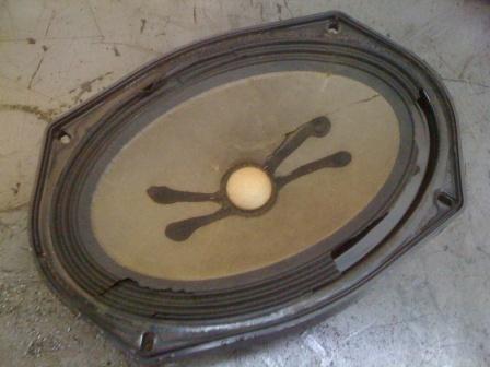

Does anyone know where the wires to the subwoofer are????? My mechanic installed a new fuel filter and he had to remove the gas tank. In the process, 2 months later which I just noticed, he cut off the subwoofer wires! My subwoofer doesn't function as all the wires to the speaker unit are cut and frayed.
I haven't attempted to remove the back seats and other areas to get to the subwoofer....yet. I'm hoping someone has traced this wire and that it's not that difficult to reconnect. Thanks
I haven't attempted to remove the back seats and other areas to get to the subwoofer....yet. I'm hoping someone has traced this wire and that it's not that difficult to reconnect. ThanksThe amplifier is above the driver's side rear wheel well. the wire travels up along the gastank to the rear 6x9 there are 2 sets of wires for the subwoofer since it is dual voicecoil.
Hope this helps
I finally got to working on the subwoofer. I followed the steps to remove the seats and all the other components. Once I got to the subwoofer, I noticed it was damaged in more areas. The actual speaker was torn of its housing. I decided to shop around for a speaker once I removed the old Harmon Kardon Jaguar speaker. It was difficult looking for a 6x9 subwoofer. Most have a tweeter and you actually have to buy a pair which is what I did. I ended up with an Alpine SPS-609. It sat a bit low on the speaker housing (hitting the gas tank). Fortunately, the set came with 2 spacers which I used to prop up the speaker and give me enough clearance from the gas tank. I only used one of the wires. This way, if I wanted to add another subwoofer (bazooka) or speaker, I can do it a later time. The speakers turned out great and I couldn't be more happier. 260 Watts of peak perfomance really delivers. As for casualties, I did damage the 3 plastic seat belt attachments on top of the seat. $30 each to replace. I'm glad I didn't have to buy a whole new seat. Overall cost of the speaker is $105 and another $90 to replace the seat belt attachments. I got beats!!!!
