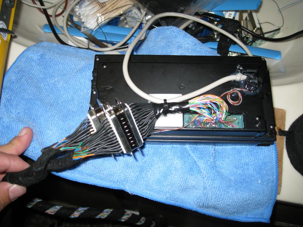

Now that it's working I added removable connectors to facilitate the installation. I just used two plain DB25 connectors one female and one male on each end so they are keyed. I also decided to move the buzzer/beeper from the head unit to the face place otherwise you'd never hear it beeping since it's going to be in the trunk. The beige cable is a USB connector, this JVC radio has it's USB connector on the face plate which I thought looked ugly so I decided to re-route that to the centre console compartment.

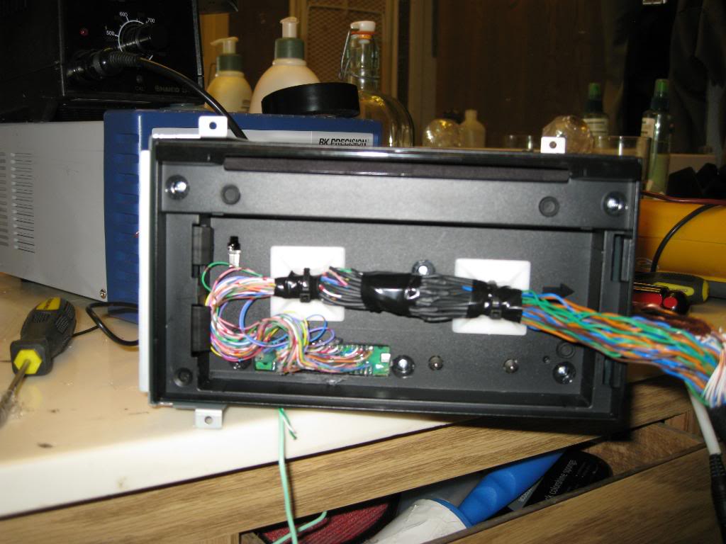

Next I put the face back on the head unit running the cables thru the former dock connector opening

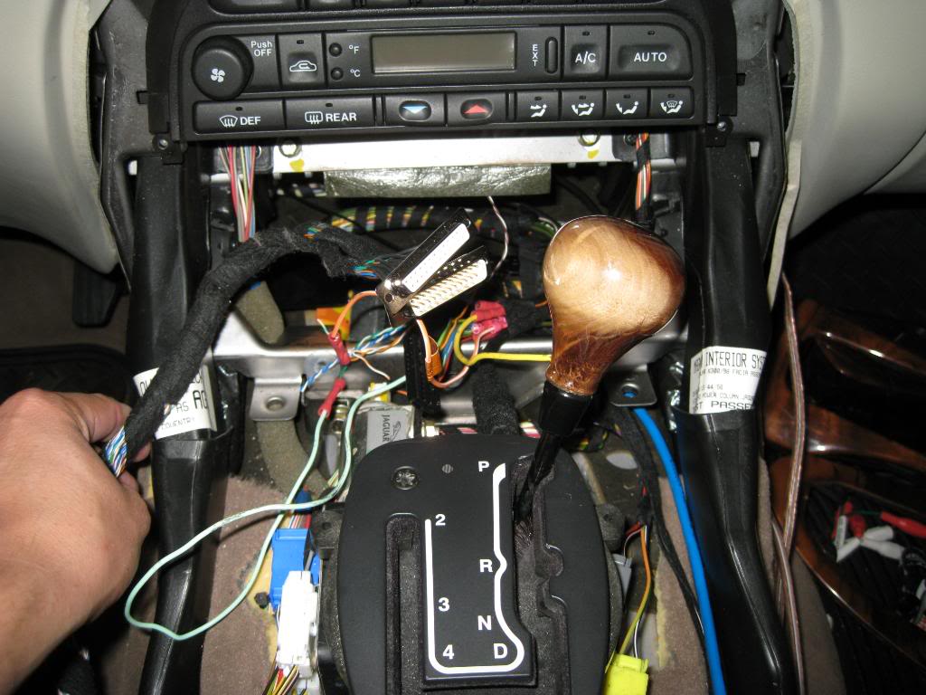

Pull the centre console out of the car, along with the back seats and the hat shelf, you will find an opening between the trunk and the passenger compartment on the passenger side of the car (LHD). Here's the cable, fortunately it was just about exactly the right length.

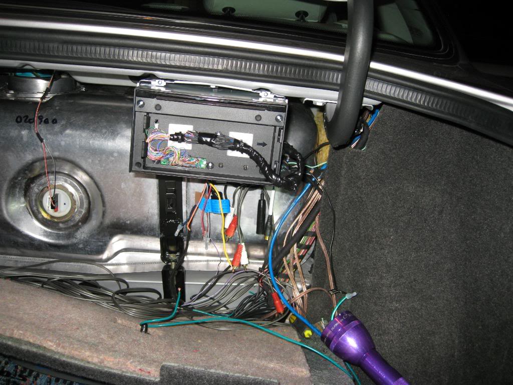

Here we are with the "head unit" now in the trunk:

Of course now that I got the whole thing in there, I realised that I forgot to install the steering wheel control adapter and run that to the back (oops) So that's a project for this coming week. The control works perfectly, I had it on the JVC single DIN radio that was in the car before we started this project.

Great project Alex, I love a good A/v install. Who would have thought about taking the screen off!
I suspect, if others wanted to do this, you could make yourself a little $$ by doing the wiring modifications necessary? I smell a side business. lol
