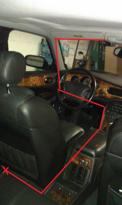

Hi all, just thought my experience may be of use to someone. I have a Valentine One. I also have the Wiring Harness Connector and the Direct Wire Power adaptor.https://store.valentine1.com/Store/partsdept.asp
I first used a fine-pointed test light to find a lead, and be sure to find a lead which switches on/off with the ignition, if it's on all the time it's not a pro setup.
Once you have a lead, run the included telephone cable along the transmission tunnel, if you have heated seats run it under that console (otherwise, I would run the wire under the floormats, I never take those out anyway).
Then, run it under the trim in the transmission tunnel trim (pry it just a bit, and jam the wire underneath.) and then run it under the steering column, and then run it over to the A-pillar.
The Material covering the A-C pillars prys of easily, but don't remove it totally (that's unnecessary). Then just run the wire underneath it along the A-pillar.
Then, just run the wire out to the rearview mirror, just set the wire in the car between the headlining and the windscreen glass. Attached are a couple of pictures of what I'm talking about.

056= Location of hard-wired detector
057= Route of wire, starting at removable panel beneath rear, driver's side seat.
Adaptor/ Connector are the ones mentioned in my first post, the connector just clamps around a sheathed lead.
link is in my prev. post. All but the adaptor (I believe) is included with the $399 purchase price of V1.
