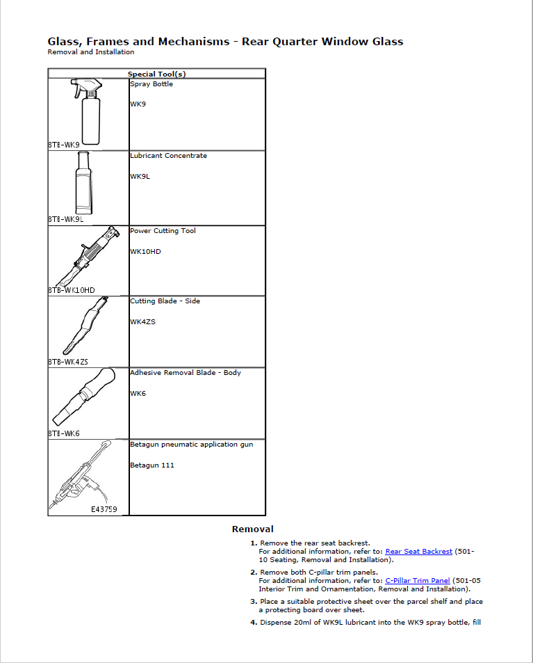

Hi, my '98 XJR has a leak at the rear quarter window on the right hand side. I gather this is a bonded window and will need to be removed and resealed. Does anyone have any info on how the surrounding trim comes out?
The car is currently off the road and we're in Covid restrictions, so some tools from Amazon are a great deal easier than a mobile windscreen fitter and I always like to learn new skills.

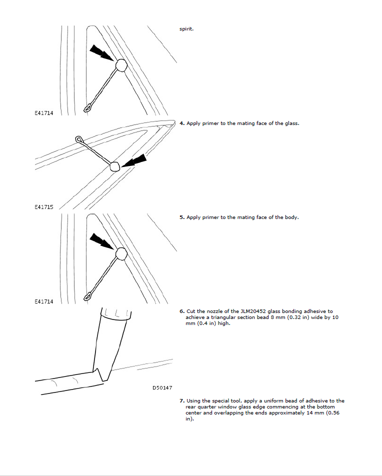

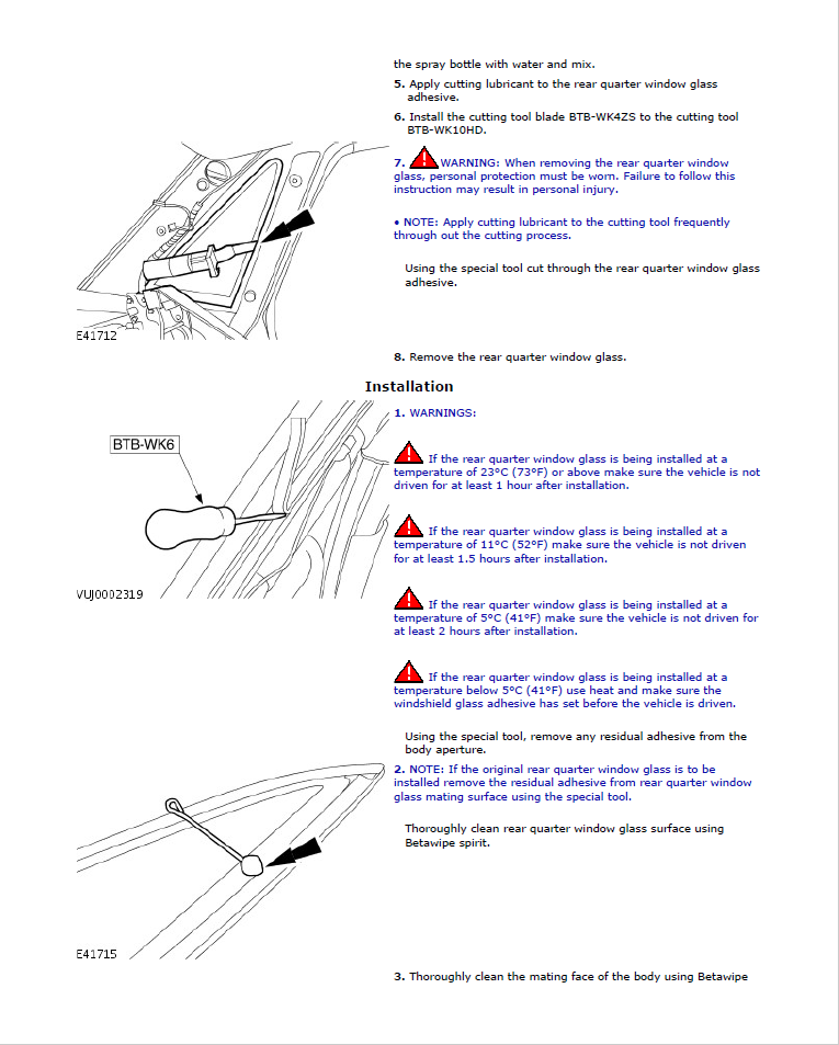

May I suggest downloading the X308 Workshop Manual, it will help you with a lot of what your asking. It can't be posted here because the file is too large. https://www.dropbox.com/s/vujkjrxklu...anual.pdf?dl=0
These are from the Manual...

Hi @Highhorse thank you very much for the link and for posting the excerpt, that's a fantastic resource to have available!
