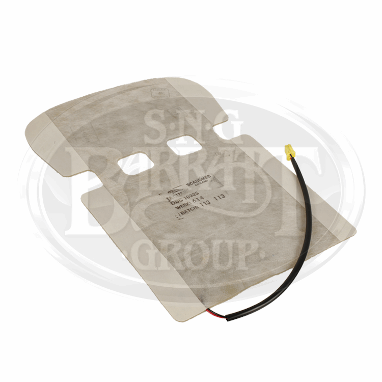

my Jaguar executive does not have heated seats if I ride this okay?

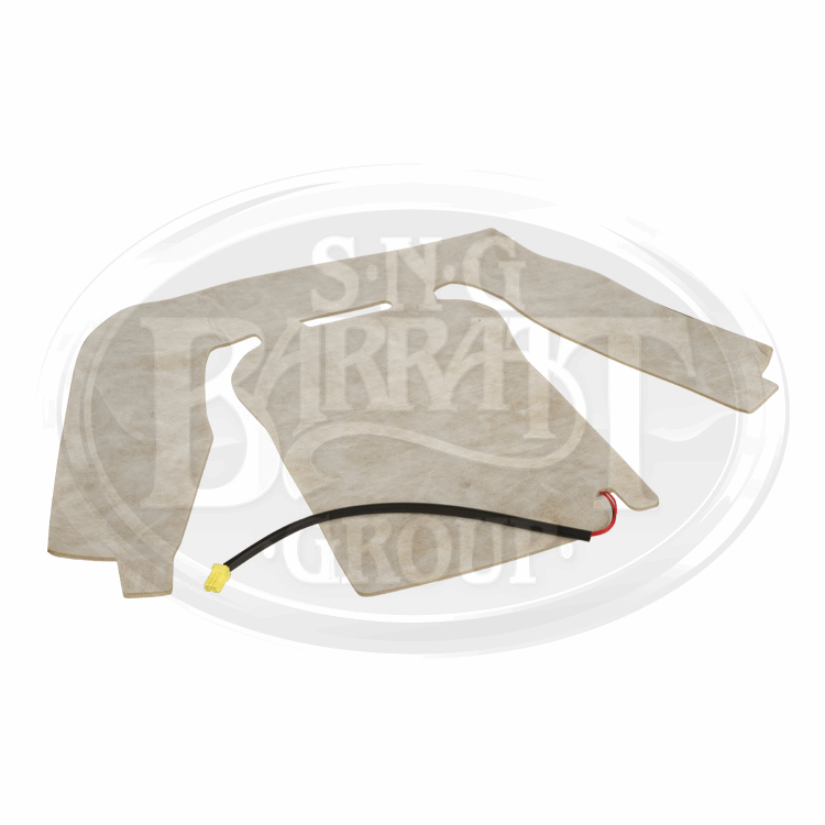

I also saw this I do not know the differences I want to heat only the front seats

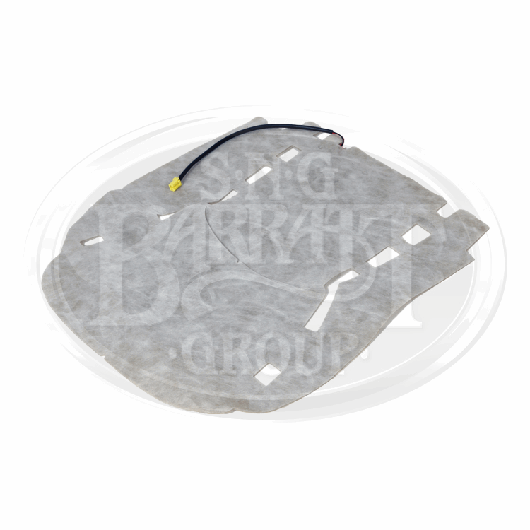

do I need 2 of these to warm up the front seats?

You can't buy parts to make a NON-Heated seat HEATED.
On the inside of heated seat is a built in multi-plug harness for the heaters to plug into. In a non-heated seat they are not there.
Next in a heated seat the multi-plug wires run down and connect to the Seat Control Module. NON-heated seats do not have the wiring to connect to the SCM. Last but not least, the SCM in a NON-heated seat doesn't have the control circuits to activate a heater.
The most common method is to take Heated seats from another car along with the SCM and the dash switches the everything plugs in and works.
With enough time and money you can duplicate a stand alone heating system but by the time you go through all of that, it would have been cheaper and faster to swap out the seats.
