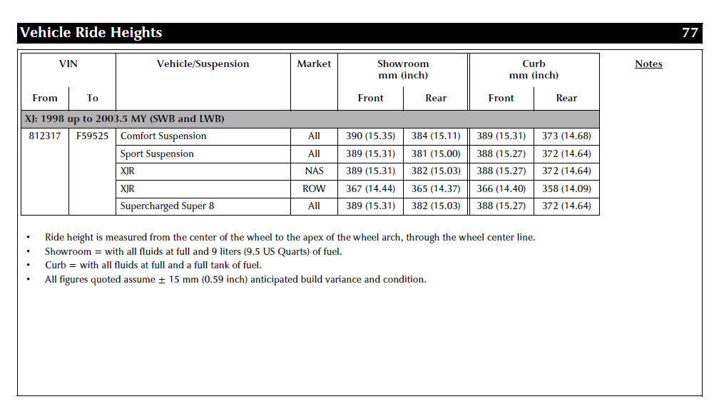

You can check your ride height.
Although very unlikely, if your car sagged extensively, or the PO got a ring of the spring cut, then camber will increase.
Most likely worn parts, or an incompetent technician though.
