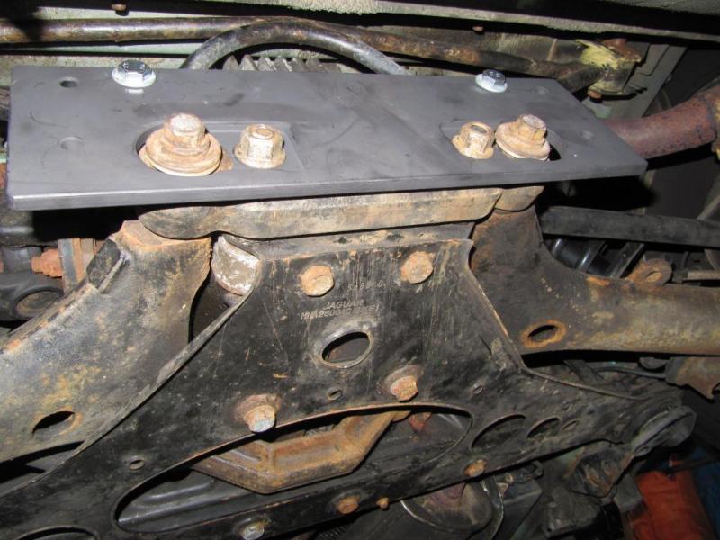

I bought an '01 VDP S/C about a year and a half ago because it is the perfect blend of power and room for the XJ. I love the car but the handling is too soft for this much engine. I found out that the rear anti-sway bar used on the XJR is deleted on the VDP. This may improve the ride on the highway but on the backroads the car pitches and understeers horribly when pushed. The engine writes checks that the suspension can't cash!
I thought it would be easy to retrofit an anti-roll bar from an XJR and that it would be a bolt-on installation. I finally found a rear bar on Ebay for $45. I then bought new Prothane brackets and bushings and new end-links for another $60 and I thought for I was all set to bolt everything in place.
NOT!
The attachment holes for the links on the control arms are there but the Wishbone tie cross bar has no attachment plates for the anti-sway bar brackets to bolt up to. I now know Jaguar used a different brakcet on cars with the bar. Rats.
So I made a template for a bracket to bolt onto the suspension and had a good friend ( thanks Rich) fabricate a bracket plate that bolts to the backside of the wishbone tie. The bracket is 3/8" steel which provides the correct offset to allow the brackets to bolt-in right where the brackets would be on the XJR. The bracket is drilled around the control arm bolts for clearance. The place and milled down at the differential studs to allow the nuts to fully seat on the studs. The bar now fits perfectly.
The handlng improvement is very noticable and the car now feels like the rear of the car is working with the front. Huge improvment. I haven't noticed any decrease in ride quality but haven't been on the highway yet. I much prefer a buttoned down ride and I am really happy I added the bar. My next mod will be to wire a switch to hold the CATS shocks in the firm setting

Great Job - a long wheelbase XJR in the making....

Looks great!
I did a similar (though Rube Goldberg in comparison) job with angle iron and an XJR sway bar and am very happy with the results. Jaguar subtle increase in handling without loss of ride smoothness.
I would be willing to pay your friend for his time and materials if he would make a bracket for me. Send me an PM if so.

Here is a picture of the factory fitted bar ( I think this is a 308 series rear-end) for the XJR and Sport models. After looking at the work involved to weld similar brackets to my wishbone, the plate seemed much easier to make. I don't now if my friend would be able to make more of these but I can provide the measurements from mine for anyone interested in this project.
I have never seen an anti-roll bar so short and attached so far inward of the lower control arms. On other cars that I have seen that outer links are much closer to the outer hub? Does anyone know why Jag kept the mounting points so far in-board?

Thank you for the picture! Seems that the brackets are bolt-on not welded; need to find a car breaker to order them also with the lot of the other parts.
The arm of the sway bar could be shorter than usual because the deformation is less than on a longer arm.

I just bought the anti-roll bar and the other bits, but if possible I am interested in the dimensions of the plate fitted on your car; I need the distances between the holes, if you have a blueprint or something like that.

Does anyone have a diagram for hole centres and diameters so I can make a plate out of 3/8?
I can easily work out how the plate to diff fixing holes are located (and sizes) but I need to know where to put the holes for the roll bar mountings too. I have no reference for that, so any help is much appreciated.

The differential carrier on the XJ-8 and the VDP (both engines) does not have the castings for the anti sway bar brackets to fit against. The CATS system is entirely separate involving the shocks only
