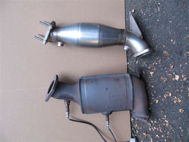

I am replacing the stock catalytic converters with with 200 cell high flow cats from Nameless Performance. Without a doubt the configuaration and design of the stock cats is the most restrictive portion of the exhaust.
Here are photos of the NP cats next to the stock units. You can see how much less restrictive the NP design is. Add the reduced cells/inch count vs. the stock units to also improving the exhaust flow, along the special pricing offered by NP, made this any easy decision as the first performance mod to my car.
The NP units are really well made and fit perfectly in place when I test fit them. I installed some a heat shield where the steering shaft crosses next to the cat to protect the rubber cover.
The stock units are fine with no sign of overheating or clogging. The driver's side cat was a challenge to remove from the exhaust manifold because of the expansion tank, houses and heat shield blocking the bolts.
Does anyone think I should change the 4 oxygen sensors due to age and mileage (87K)?

Yeldogt- thanks for the feedback on the sensors. The cats must have been installed attached the engine on the assembly line judging on how hard it was to get to the studs from the engine compartment.
1 of the studs is angled towards the head and impossible to get a straight extension on it to break the torque.

I moved the coolant resevior out of the way be first syphoning out the coolent and then removing only the hose underneath. Then I tilted the reservior, with all the small tubes still attached, up on top of the engne and tied it off.
Next I bent up the top of the heat shield to get to the 4 studs. The NP cats are very well made and they bolted right into position without a problem
