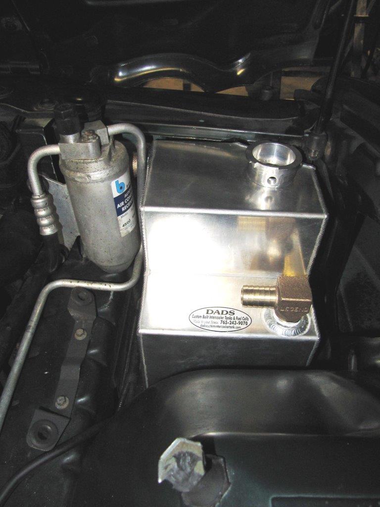

I decided that I would benefit more from increasing the capacity of the cooling circuit rather than trying to increase the intercooler radiator size. I installed a custom reservoir that I had made and it adds an additional 6.5 quarts to the circuit. This is far more effective in limiting heat soak when stopped than a larger radiator will be. At highway speeds the stock radiator is providing adequate temperature drop but at low speed or when stopped heat soak to the entire circuit causes the ECMto pull timing
I installed the tank in the space I created by relocating the filler neck forthe windshield washer fluid and connected in line with the intercooler pump and hose leading to the intercoolers. Total cost was less than a larger radiator would have been

@rocklandjag and @avos - I know this is an ancient post, but just wondered how you established the dimensions and had the intercooler expansion tank made?
