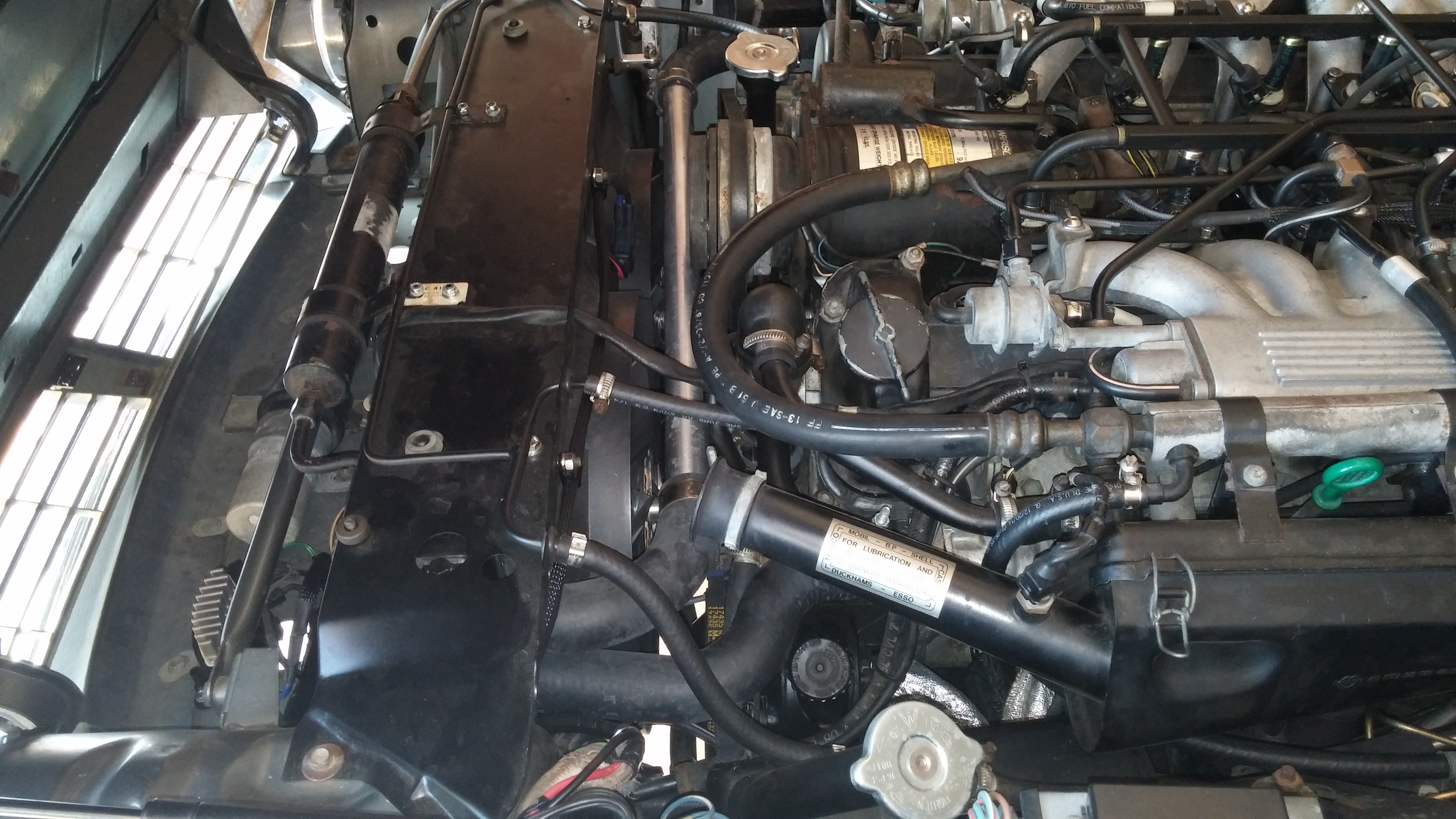

When I had my radiator rodded by the local radiator shop, I had the right inlet removed and placed under the left inlet. This created a full double pass since the baffle in the left end tank wasn't removed.
I ran the right coolant hose across the front of the engine and connected it to the top inlet. This gives it a bit of pitch to allow air to escape out the bleed screw on the radiator. The left hose is nearly level with a slight pitch upwards as it enters the radiator.
So far, I have had no issues. It was easy to bleed, and I've idled it for extended periods in 90+ degree weather. Keep in mind, I have dual electric fans. Also, my A/C is nonfunctional at the moment. Next summer will be the real test. I'll try to post some pictures later.

Here are the pictures I promised. I hope these help to give you some ideas. The radiator modification, pipes, hoses, and clamps cost me less than $200.
Attached Thumbnails Single Pass Radiator Mod for V12-20150930_175040.jpg   Single Pass Radiator Mod for V12-20150930_175057.jpg   Single Pass Radiator Mod for V12-20150930_175118.jpg   Single Pass Radiator Mod for V12-20150930_175133.jpg

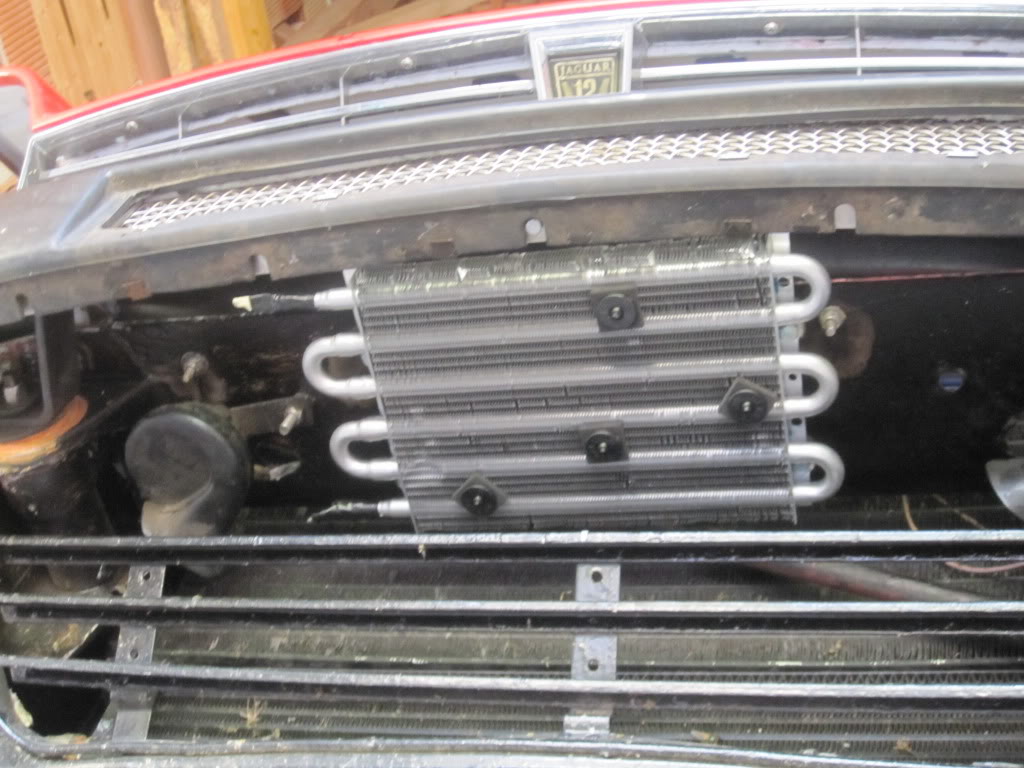

Could one just use a universal trans cooler as a separate entity? I see them running for $50 - $100. Any benefit of doing this?
As Baxtor says above, this is a Grant Francis recommendation too. I have done it, and completely bypassed the in-rad gearbox cooling. This has the added safety benefit that no water can get into the gearbox if the cooling coil fails inside the rad.
Here is a pic of the fitment on my car just before the pipes were connected, works brilliantly, plenty of space in this location.
I've often added an external trans cooler but always in conjunction with the in-radiator cooler, never to replace it outright.
My worry is lack of ATF cooling during long idling periods where there is little or no airflow across the cooler. In such conditions the ATF would still get some cooling via the in-radiator heat exchanger.....were it still in the loop.
I'll confess, though, that I've never researched (nor actually measured) how quickly the ATF heats up when the car is stationary. It might be a non-issue.
GM didn't think it was an issue 50 years ago, as I discovered while working on a '64 Corvette. The Powerglide transmission has only an external cooler.
Doug, I started with the rad and the extra cooler in series, and the extra cooler was never more than fairly warm, even after long high speed runs. So this summer I changed to the external cooler only (which is what the great WoOz who advised me about positioning, recommended to start with). Even an hour in hot Paris traffic jams seemed to be fine. All in my quest to simplify wherever possible.
