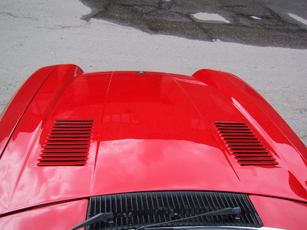

and this is how this guy did it! letting the hot air out from under the hood!
