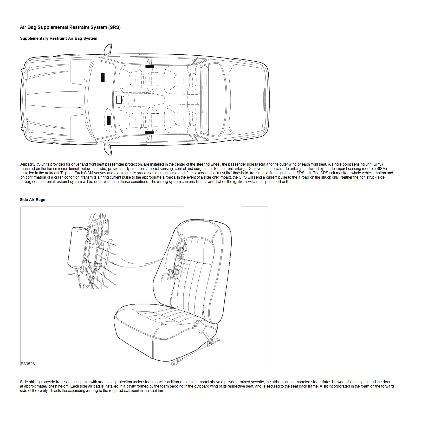

Deployment of the side airbag is initiated by a SISM (Side Impact Sensing Module) installed in the adjacent 'B' post. Each SISM transmits a fire signal to the SPS (Single Point Sensing ) unit in the transmission tunnel. The airbag system can only be activated when the ignition switch is in position II or III.
It's looking like a short in the harness under the seat.
