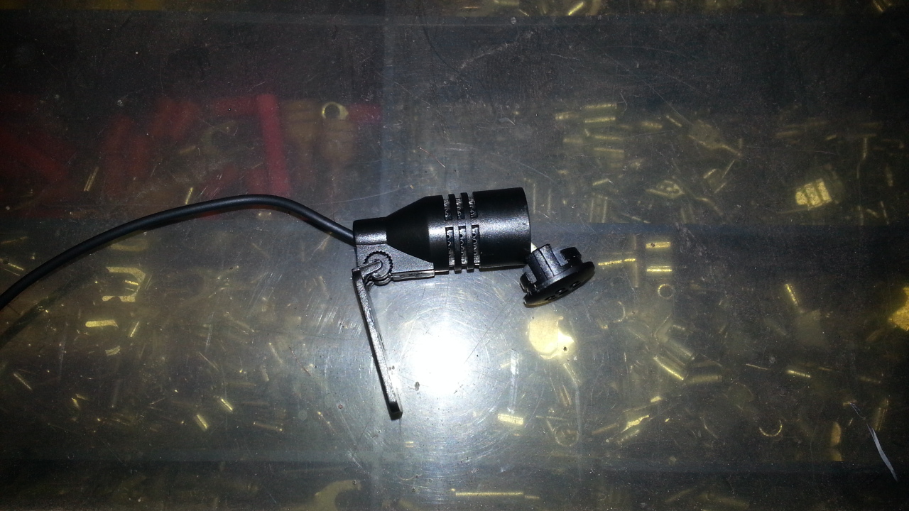

I just did the Motorola Bluetooth modification today but went a little farther with the modifications so I figured I would share.

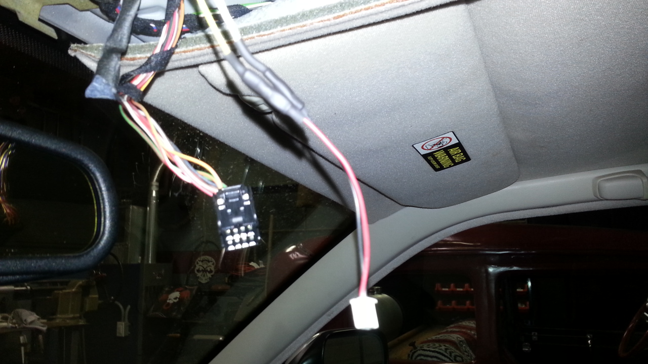

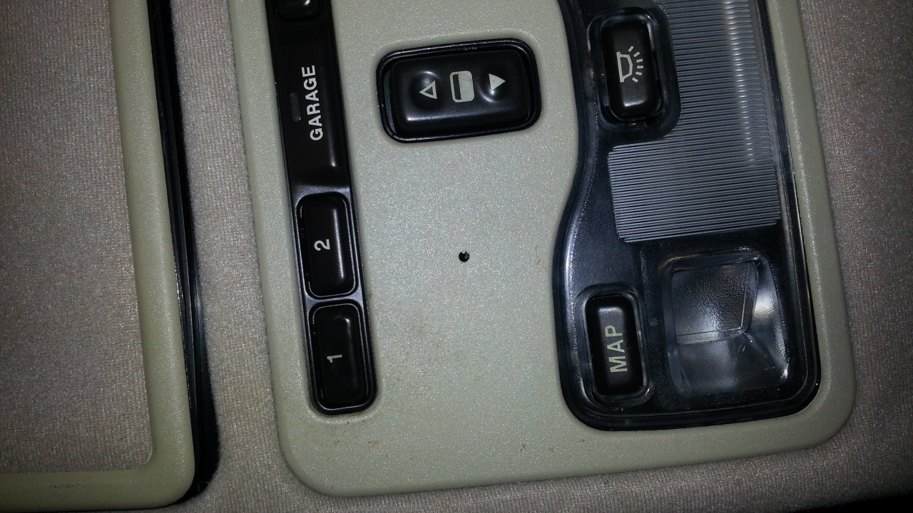

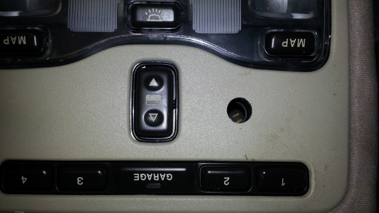

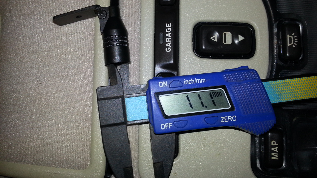

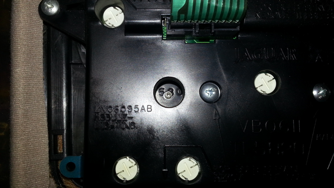

First off, I wanted the mic to be a bit more "built-in" so I put it in the overhead controls - here's how...
Open the mic up. I was able to pry the cap off with the help of a little screwdriver

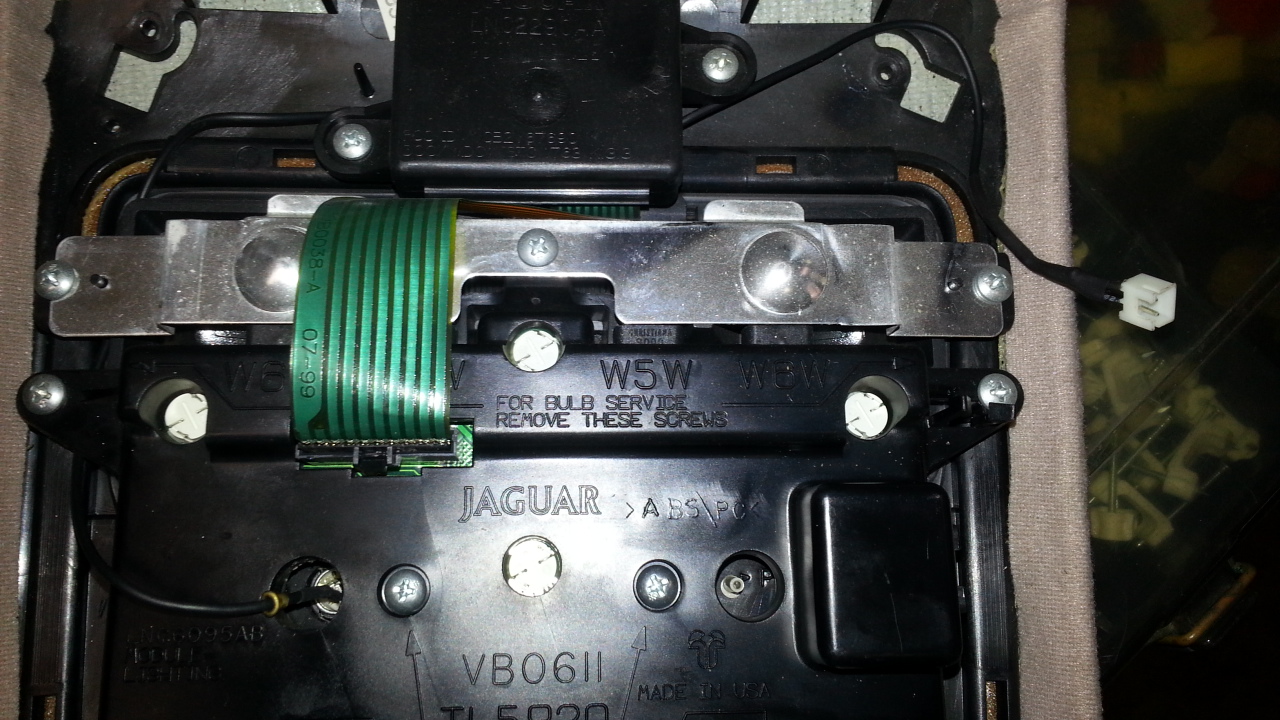

Locate where it is going

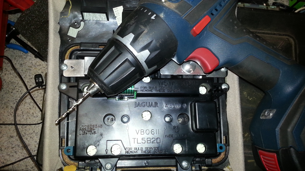

Drill a pilot hole
Measure mic opening
Drill to size

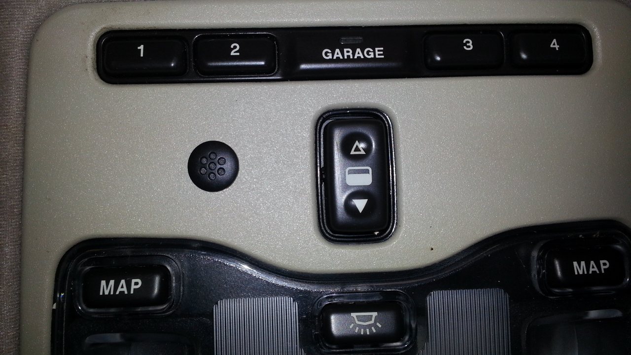

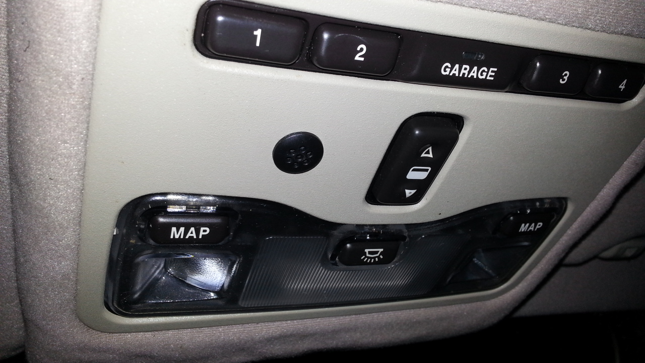

Press mic in, I had to file a little slot in there to make the mic go in all the way.
Then I routed the mic wire around and put a small connector on it
Added the mating connector up top
Mic installed!

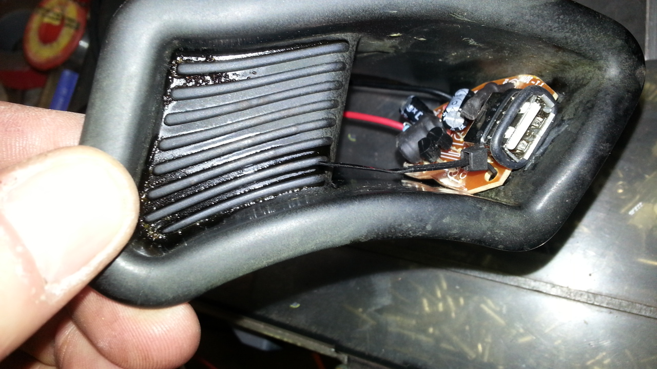

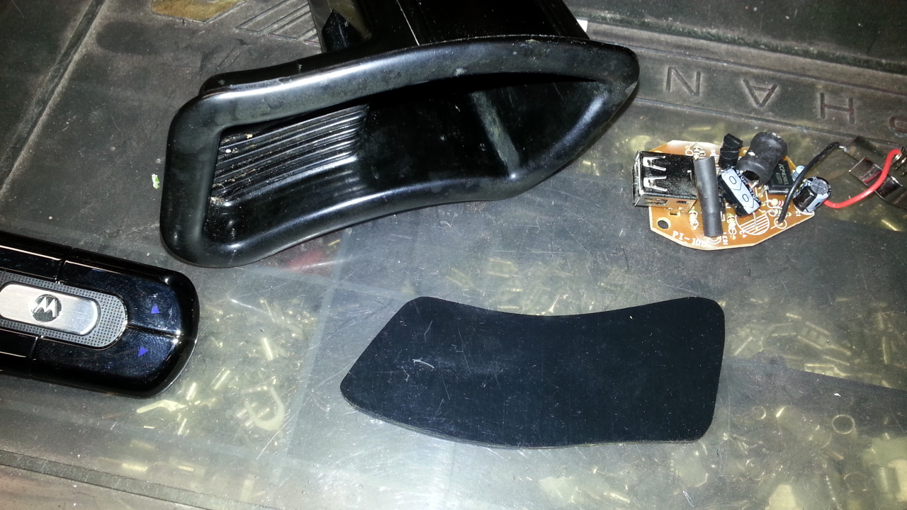

Now I had to mount the control, I also wanted to get a USB power in there while I was at it so I gutted a lighter socket USB charger for this next part, made a plastic insert for the ashtray, cut the bottom off and drilled a pass-through hole in the ashtray receiver in the console.
USB charger guts in the ashtray
Wired in and mounted.
