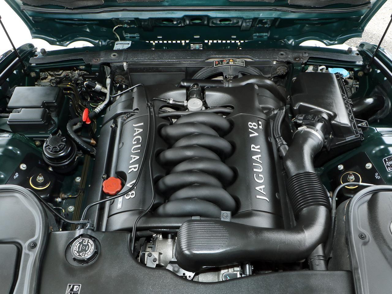

I also have a 3.2. That green one looks very nice.
In terms of price, I think the price you mention is going to seem very high for the majority of US members here, where I believe these cars do not command high prices.
In Europe, with that low mileage, it would not be rare to see a car advertised for that price. What it would finally sell for, is a different history. Hey, people are not rushing to buy these cars, that plays in your advantage.
What is important is that you can get maintenance records. Nothing worst than to be chasing after issues when you don't know what was done previously.
Being a 2002, I believe the main issue of these cars, the timing chain tensioners, would have been already addressed, replaced by metal, but please do ask the dealer for the engine number (should be in the conformity document I believe) and you can check to be sure.
You will also have an upgraded water pump, I believe.
With those few kilometers, I would be overall concerned if the car sat for a long time. Many parts don't like to sit for a long time, like the fuel pump. Take the car for a long ride, make sure no lights are showing in the dash.
If they can't proof maintenance, you'll need to replace all fluids and consumables accessory belt, etc) to have piece of mind.
In terms of 3.2/4.0, I believe if the 3.2 is a good one, go for it. Nobody buys these cars to test 0-100 km/h every day, that is my opinion, and the 3.2 is not underpowered.
Edit: I see the thermostat tower cap is aluminum. Somebody chime in but I believe factory was plastic, so it might have been changed, which could be a good sign: prevention. Or sign of one that failed, with hopefully no consequences.

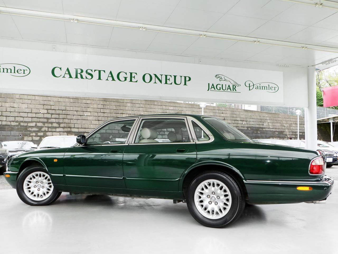

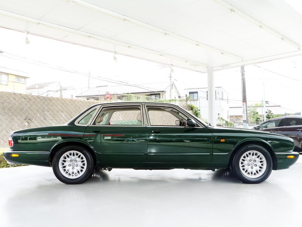

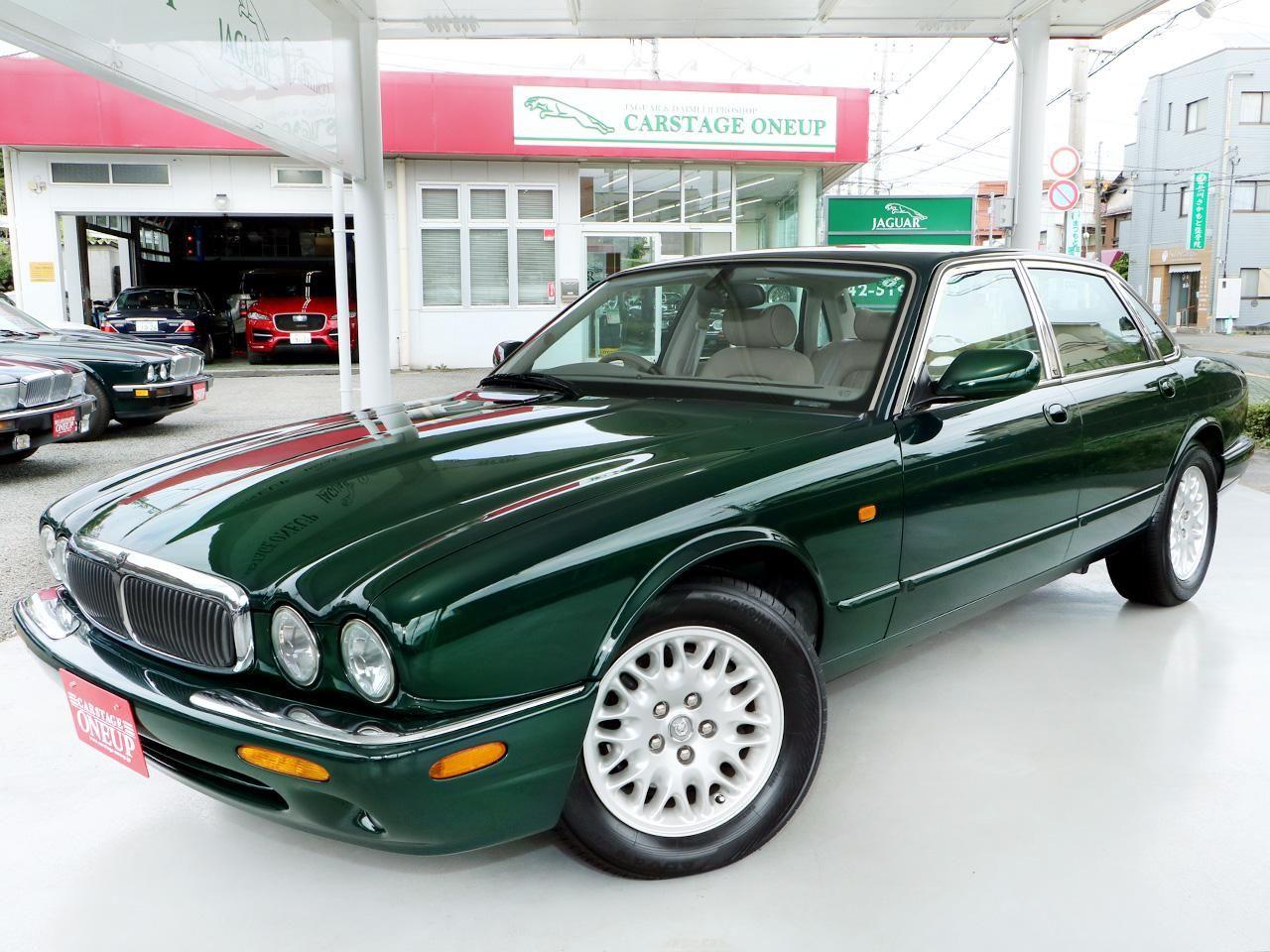

Am I alone in thinking this car is sitting higher than normal on the suspension? The tire/wheel arch clearance looks higher than I expected.
Old Dec 17, 2025 | 09:33 AM
Ken Cantor's Avatar
Joined: Mar 2022
Posts: 4,565
Likes: 4,175
^ To my eye as well.

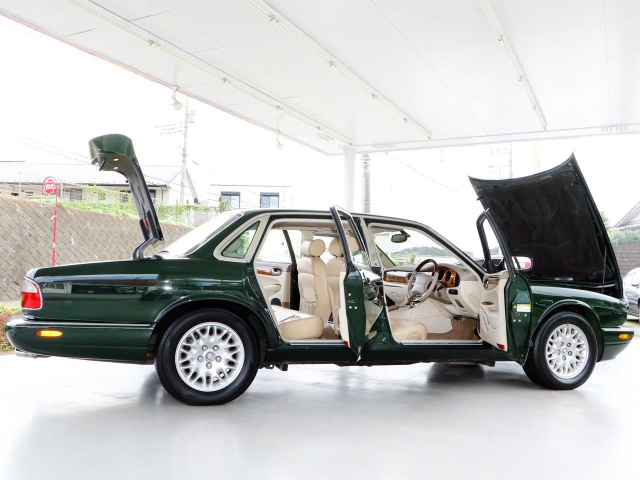

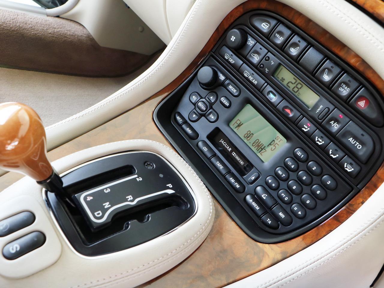

It also looks as though the wood fascia panel above the glove box may have been replaced as it's darker and the grain doesn't seem to match the centre/driver's pieces and it looks to more than just lighting/reflections.

Are the coachlines missing?

Very pretty car but I also note that it sits VERY high?
Compare some pictures to see. Now I have heard JLR will raise the car when it's sold in certain markets like the middle east and Mexico. Maybe Japan as well?
