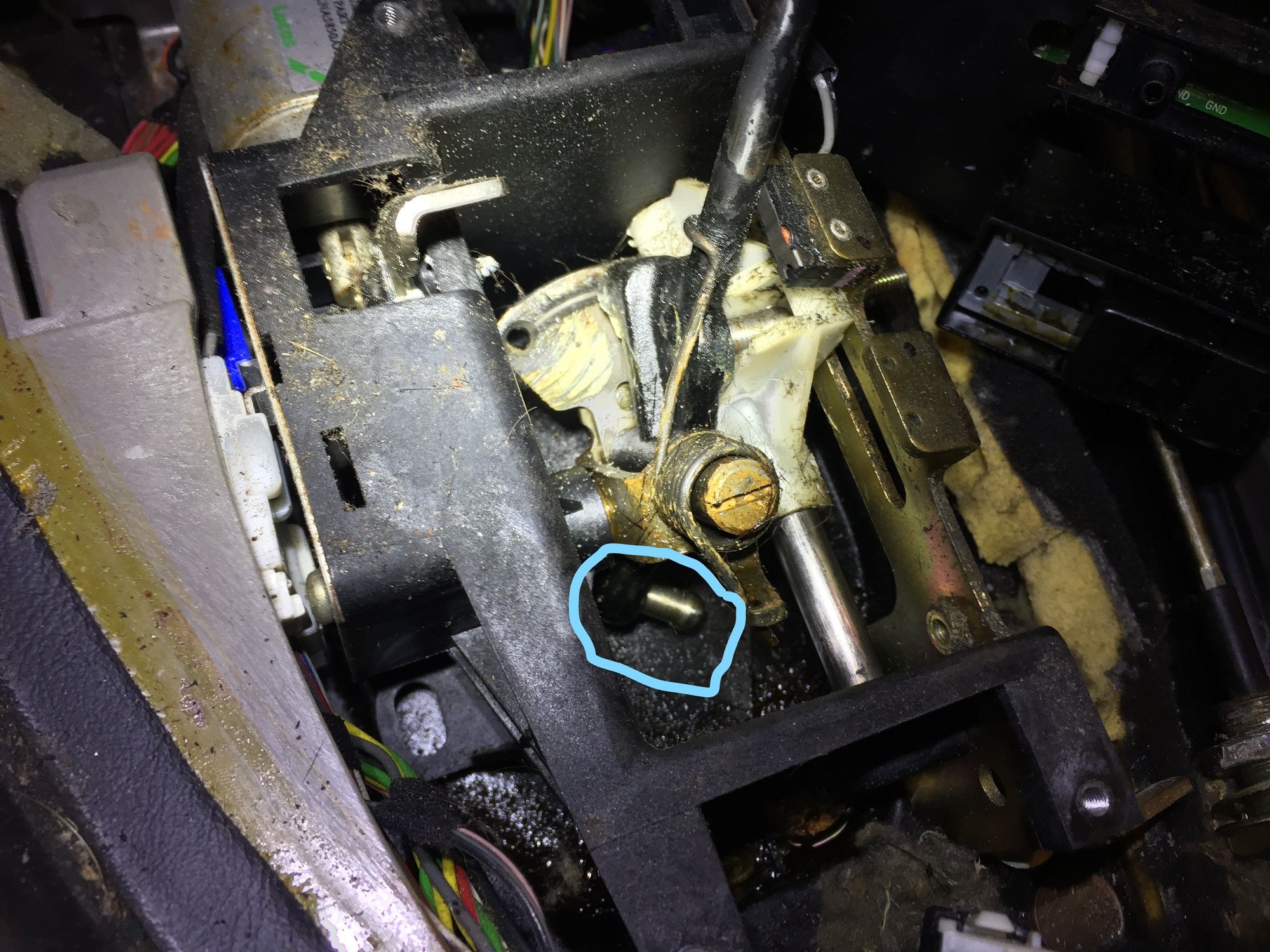

I saved an XJR from the wreckers.
It started at the yard, and although the shifter was very stiff, it would engage reverse.
I got it home, and found that the ball at the bottom of the shifter was bent back, and no longer engaged the linear switch. Someone likely forced it.
I unhooked the cable, and got things to move, but now I can't get it to start.

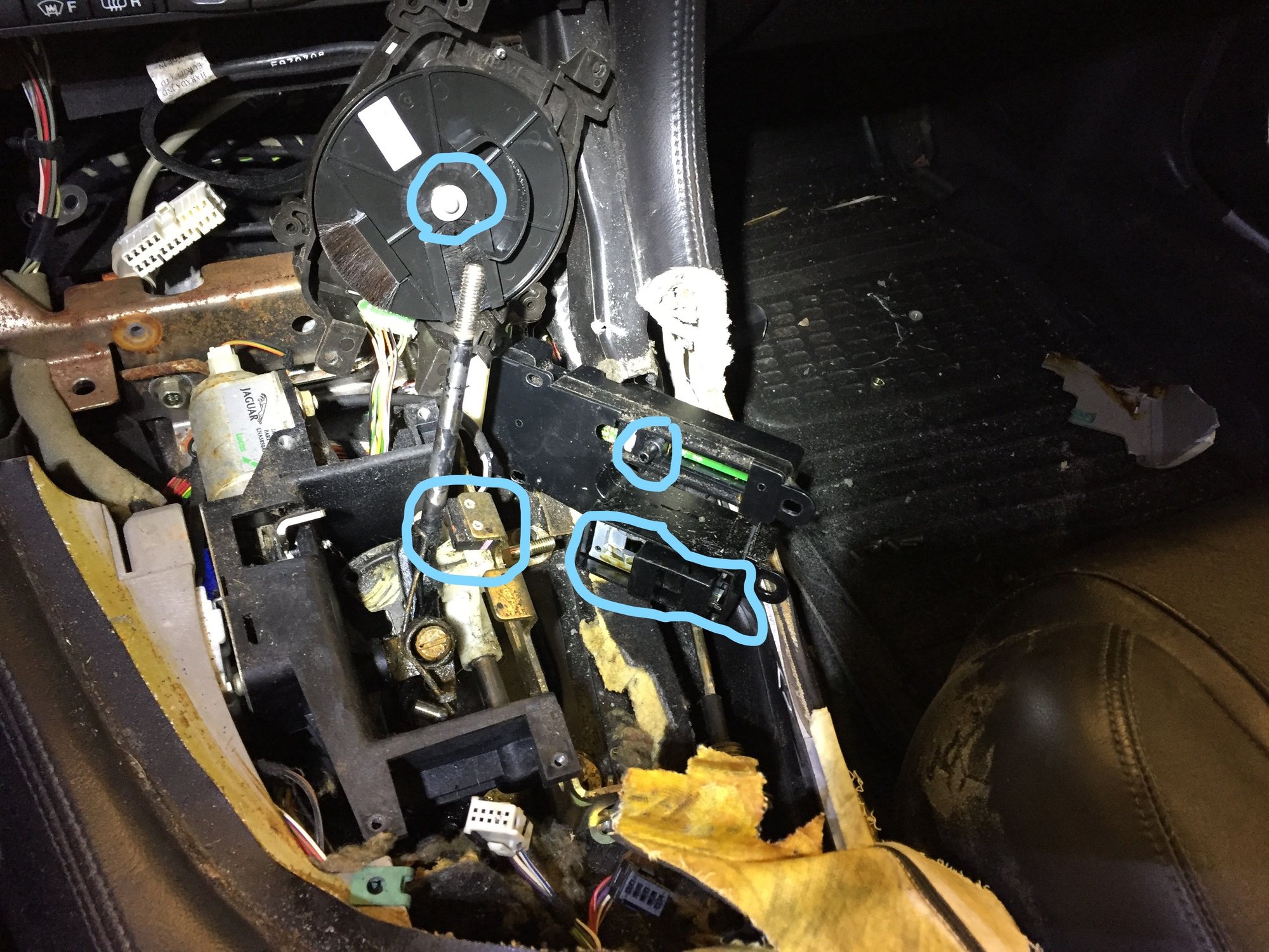

I know the micro switch on the shifter has to be depressed, and the upper slider of the linear switch should be forward, and the lower part rear-ward.
I'm not sure if there's anything in the rotating cover that has the P R N D on it.
I'd like to get this running, and hopefully see if the trans wroks.
Any ideas?

I'm trying to get the motor to crank over, but I need the right combination of switches to enable
Thanks,
Rob
