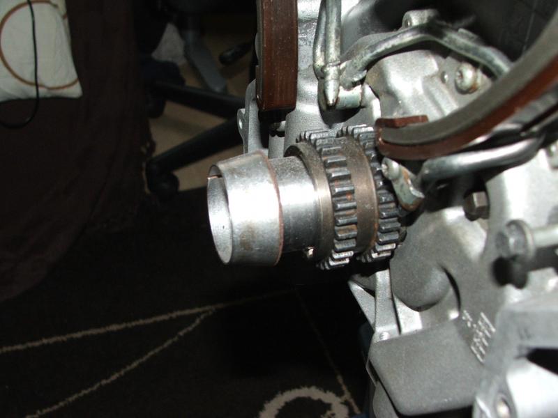

The crank cone picture is included. You might not be able to see it because of the new member status, if so contact a moderator to give you full access to forum resources.
