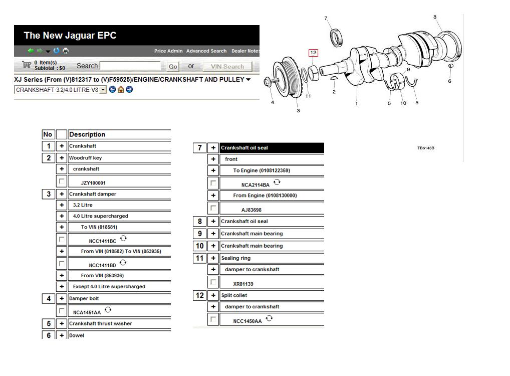

Here is a JPEG of the Jaguar Electronic Parts Catalog page showing the diagram and most of the componet part numbers for Damper Bolt (Bolt), Damper (Pulley), Sealing Ring, Split Collet (Cone), Woodruff Key, Crankshaft Oil Seal, Crankshaft and the other remaining parts:

Yes, but what is #11 in the diagram pic? Where does that go? It seems like I need the bolt, pulley, cone and whatever #11 is?

I got the pulley yesterday from Adam and ordered all the new parts from the dealer today, bolt, cone, crankshaft seat and that #11 washer, so when I put it all back together next week (since dealer doesnt have the parts in stock) ill let you guys know how it goes, also, what do you guys use to lock the pulley when tightening? I was able to use a bmw trans bolt 5hp-24 that fit right in the flyweel, kind of worried that it might snap though since I have to torque it to 350tq

#11 is a sealing ring (o-ring) that goes inside the pulley- look on the engine side of the pulley and you will see a groove which does (or does not) have something in it.
