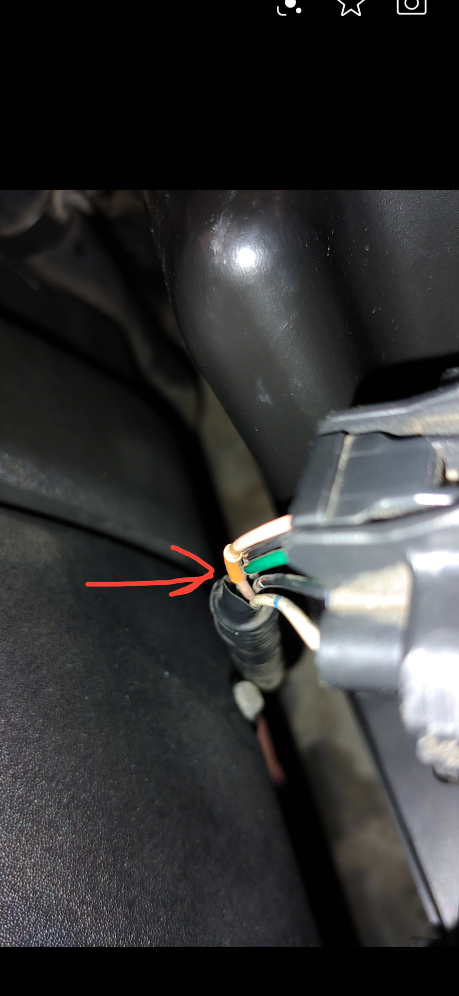

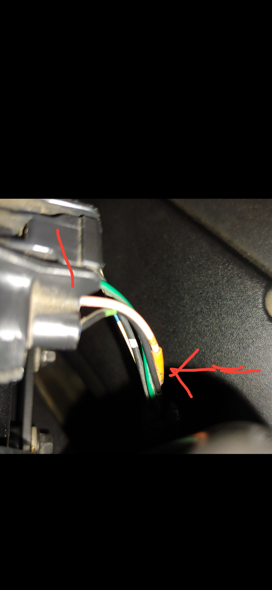

That said, I did see something on the MAF harness. My dad has an 03 xjr r1, and a 99 vdp parts car. Neither of those have what I saw on my MAF harness. Pics to follow later.

First two pics are from my car. Last one is from my dad's 03 xjr. Notice how on my car, where I have the red arrow pointing, is like some kind of crimp. I looked at all the sensor harness' in the engine bay. The MAF harness is the only one to have something like that. Who knows if a previous owner had this problem in the past. But it is worth noting that the MAF harness is the only one to have it on my car. And looking at my dad's two x308's, those car's MAF's don't have the ceimped looking wire.

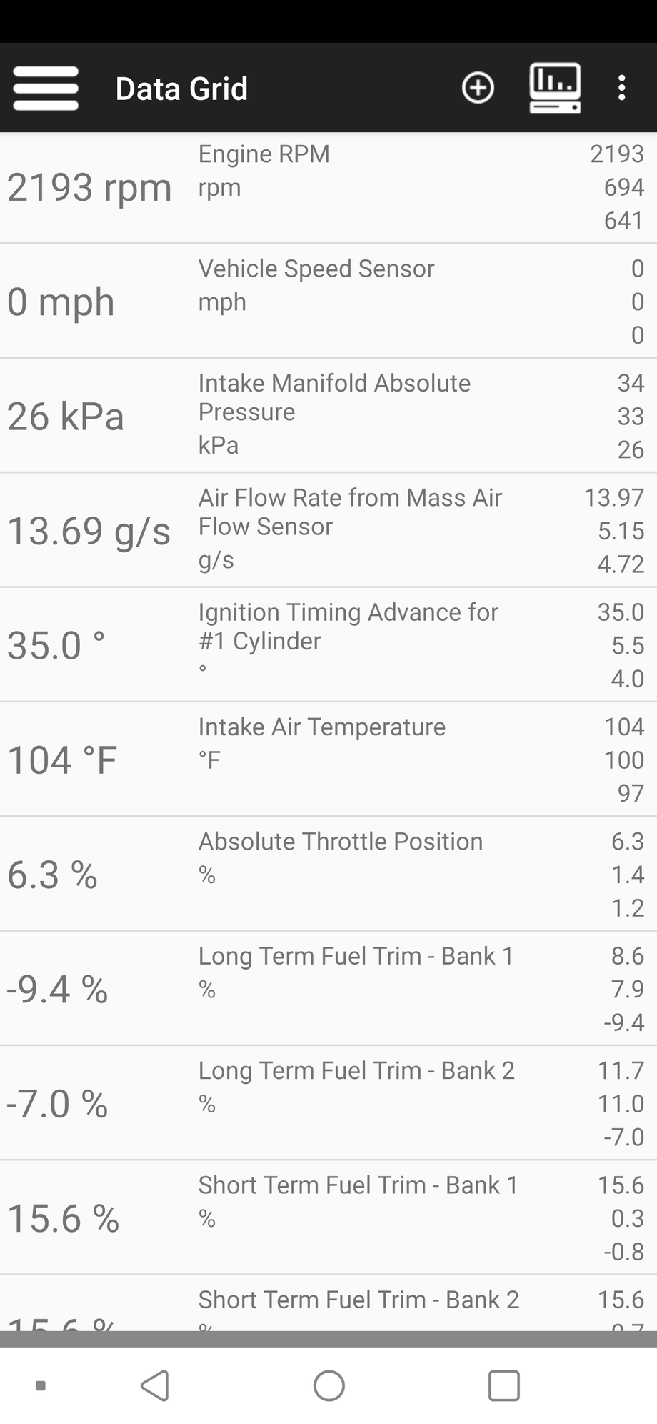

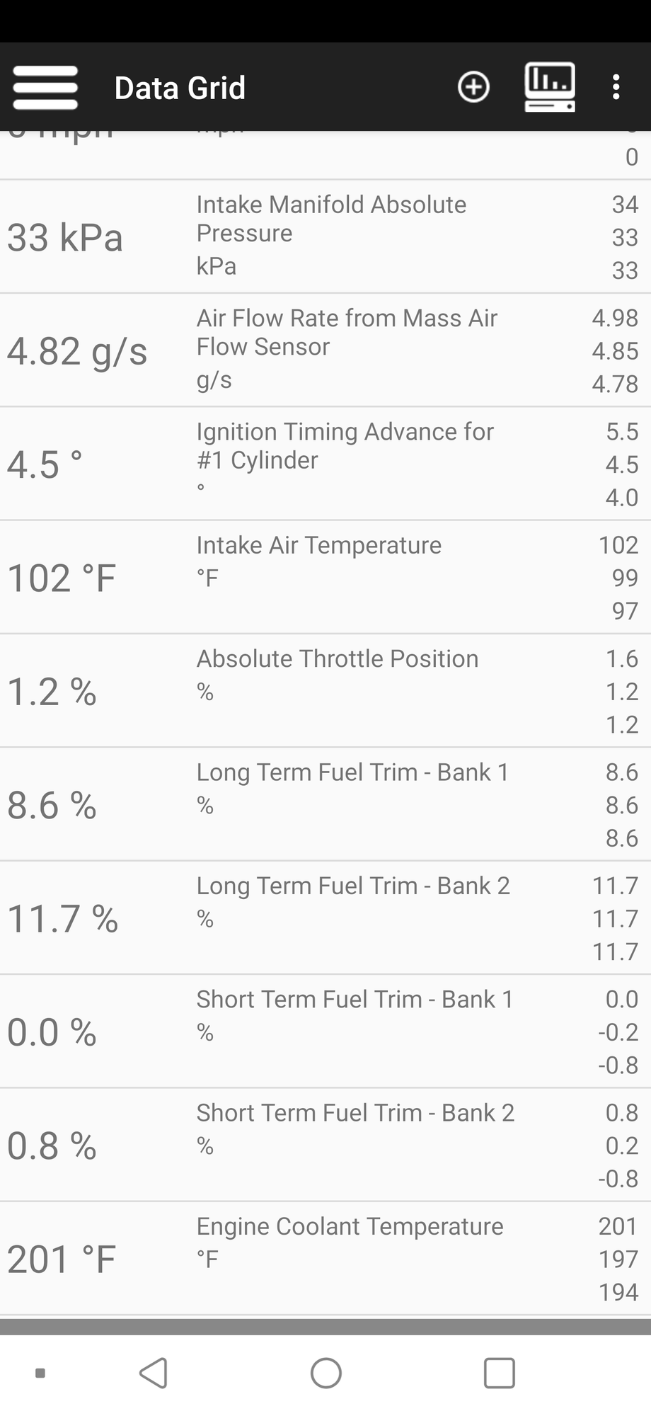

1st screenshot is idle.
2nd is with a steady throttle input.
Oddly, the long term fuel trims show rich at part throttle. Yet the AFR is lean.
Also, I can't read o2 sensor 1(both banks) in Volts. Only in mA. So I'm trying to figure out how to understand if my o2 sensor mA readings are good or not.

They sounds like wideband (linear) O2s - they are current-sensed only.
