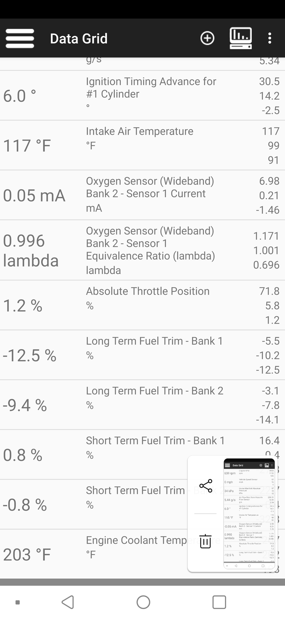

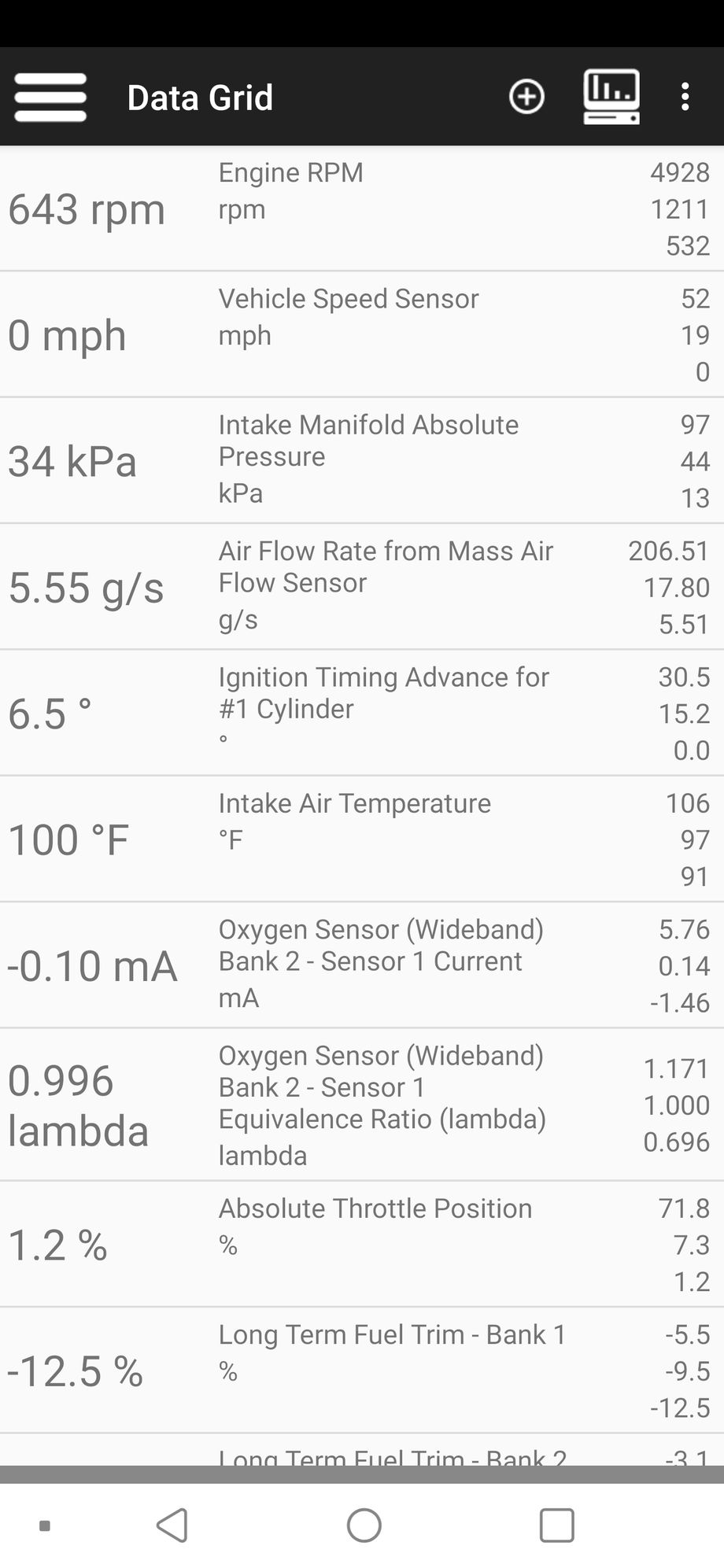

Was out driving this morning. Car felt like it wanted to die when I put it into reverse. So, I scanned it. No CEL(check engine light) is lit on the cluster. But both codes are pending. Here are some screenshots.
Any pointers? Car has lately been cranking a little longer on cold starts.
Mods the car has. Just a Mina intake tube and BMC air filter.
I know it says to check for incorrect signal from ECTS, MAFS, IATS and TPS. But everytime I check those, I never see anything wrong. Air filter new. What are the correct fuel pressures for an aj27s? Maybe that's something I need to look into.

Based on your fuel trims, I would check that BMC air filter. I'm also running one and I find that it needs to be cleaned more often than a stock box with a K&N filter.

If it were the MAF, wouldn't the MAF readings be wrong?
