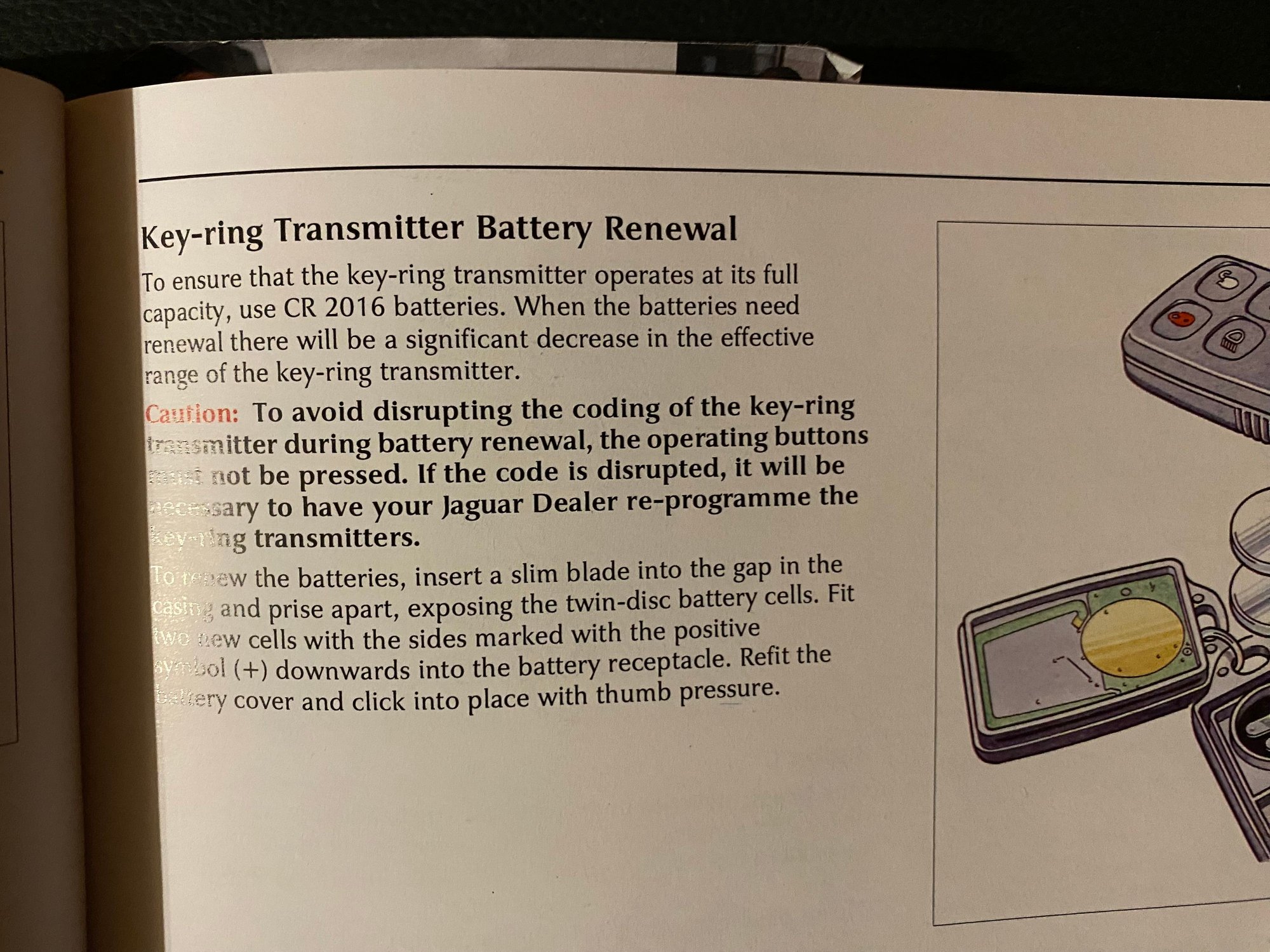

I think the handbook says 2x2016 not 1x2032. People say it's the same thing but I know my fob responds faster and from further away to a button press with 2x2016 than the other way. That's both as new fresh batteries too.

Damn, i was dropping 2032 into fob since always, just swapped 3020 for 2016 and now it locks from 20m at least v 5m with 2030
This fob gives up on just below 3v, partially discharged 3v+ battery may be ok on warm day but drops to 3v- at subzero thus fob stops, warm up fob and it will go for a while but drop out at next cooling event, it gives really narrow margin of use and almost full battery may cause problems on cold days, it won't happen with 2x2016 which will drop to 1.5v per cell before fob gives up
That's what my handbook says for a 2000 UK car too, with the later frequency fob. As far as I'm aware the only change from the early to late x308s fob wise is the frequency. Hence I use 2x2016 & it solved the issue for me.
The photo above was from the handbook for a 2001 XJR so I’m not sure when that switch might have been made.
