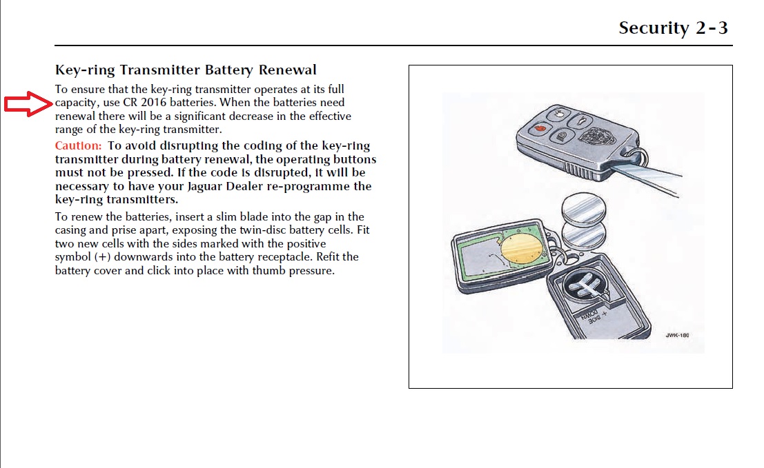

Originally Posted by Bcrary3
..... It doesn't say anywhere inside the case which battery to use.
NO - but it does show to use CR 2016 in the Driver's Handbook:
Two CR 2016 required.

Hi there.. I'm just getting organised myself with a new XJ8 (17 years old new lol) and as always the keyfobs needed new batteries.. a CR2032 will not do the job adequately as it supplies 3V, and the recommended CR2016s are half the thickness and 3V each, two of them giving a 6V supply to the keyfob.

...a CR2032 will not do the job adequately as it supplies 3V, and the recommended CR2016s are half the thickness and 3V each, two of them giving a 6V supply to the keyfob.
Yep. Steve's right. When you stack them they're in "series", giving the total volts they have:
3v + 3v = 6v
90ma - amps aren't added together.
If they were sitting side-by-side, you'd have a "parallel" connection.
3v + 3v = 3v - volts aren't added together
90ma + 90ma = 180ma - milliamps are added together
So x1 2032 works, just barely - not enough voltage - it's 225ma are sufficient though.

The keyfob circuit is designed to work at 6V, much the same as most electronics worked at higher voltages years ago.
Two of the correct batteries (3V per battery) give you the required 6V total for the circuit to run normally with a fair range, but the same as your remote controlled toys - if the voltage supplied to the transmitter falls (ie batteries failing) it still works but over a more and more limited distance as the voltage falls.
But please note this does *not* mean that if you power your remote via a car battery strapped to your back you can arm or disarm your alarm from a block away lol
The keyfobs are designed to work with a 6V supply but I dare say will work at much lower voltages just with a more and more reduced range..
