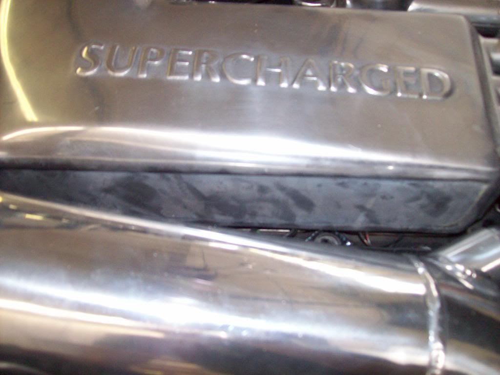

This is how cold you can get the charge coolers with a Killer Chiller. If you call & speak with Joe @ Kincaid Performance he will set you up with what you need. I strongly recommend you eliminate the radiator for the supercharger & replace it with a tank. You should also isolate the cooling system with a second reservoir & pump.

I just used a Jaguar reservoir from an XJ8. The second pump is a Bosch Pump. The tank was made by my local fabricator.
Attached Thumbnails Killer Chill for an XJR-014.jpg   Killer Chill for an XJR-killerchiller014.jpg

JGAXKR, where sourced you the carbon fiber cover? very thing in the picture is like ****...blood is running hot now !!!
