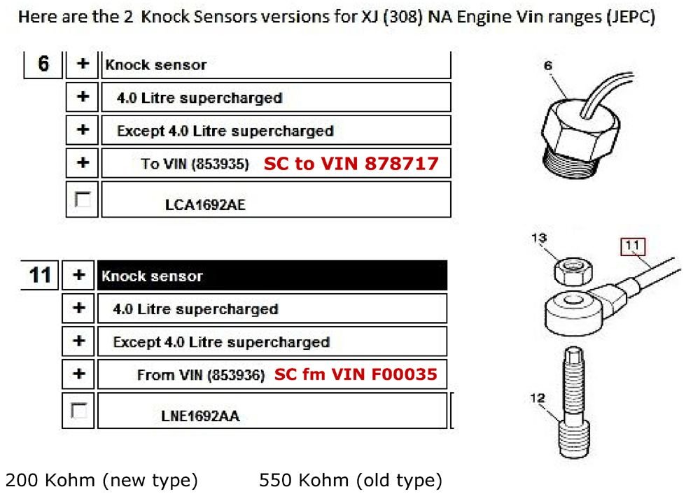

Go out to the car and open the hood. You may or may not have the “Jaguar V8” plastic covers on both sides of the intake manifold. If they’re there and in good shape, I’d recommend “gently” removing them. Once they’re out of the way, take a flashlight and look down inside underneath the intake manifold. Since you have an earlier AJ26 engine management system, you should have a bolt style knock sensor. If you’re unsure, take a quality photo and post it on here. Also, where that new aluminum thermostat housing is now, there “should” be a black 2 pin connector mounted on each side of it. Post those pix as well.

Normally I’d agree with you Jhartz but, the problem is if the car goes into RP, the CC will be disabled. What I’m trying to find out is if the shop 1) legitimately replaced the knock sensors? 2) did they install the correct bolt style KS’s? I’ve seen an AJ26 with the factory KS still in place but had an AJ27 KS plugged into the harness just laying underneath the intake manifold. The thing is, there’s a rather large OHMS gap from an AJ26 KS and a AJ27 KS. Since there’s no ohms listing for either of them, over the years I’ve recorded what a new oem Jaguar early and late KS should read right out of the bag. I have that information in one of my older phones which isn’t with me at the moment.
