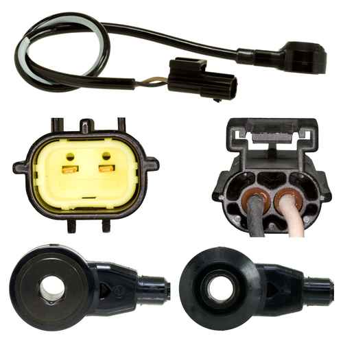

I have received a lot of requests for this info so here it is.
I bought my knock sensor on Ebay for $28: http://www.ebay.com/itm/AIRTEX-5S561...d65ea1&vxp=mtr
I decided to relocate the left side knock sensor on my 01XJR rather than try to R&R the supercharger.
I left the old one in place, plugged the new on into the wiring harness and attached it between the intercooler and the supercharger body. I used heavy duty zip ties and heavy duty epoxy to secure it. (I know, but it worked)
I have put about 500 miles on my car with no problems and no codes.
I always use 93 octane premium and I live in Florida so no high altitude or mountain driving for me. I still have the right side sensor in the original location and I think the chances of me having any serious engine knock that would not be detected are pretty slim.

Attached Thumbnails Knock sensor relocation 4.0 supercharged.-4.0-jag-sc-jag-engine-top-view.jpg

Glad it worked - I could see no logical reason why it shouldn't.
Aluminium's a pretty good conductor of sound and the signal to noise ration the sensor's looking for is pretty big.
Even as a temporary fix until the day you HAVE to pull the S/C off it seems pretty good.
How did you cope with the connector? Presumably the original is still plugged into the defunct KS.

No, the new connector is plugged into the original harness connector for the knock sensor. The old knock sensor is unplugged. I'll post a pic to this thread when I can.

Does it come with a flying lead then ?

Yes, it plugs right into the OEM lead on the engine.
Vector
Attached Thumbnails Knock sensor relocation 4.0 supercharged.-knock-sensor-pic.jpg
