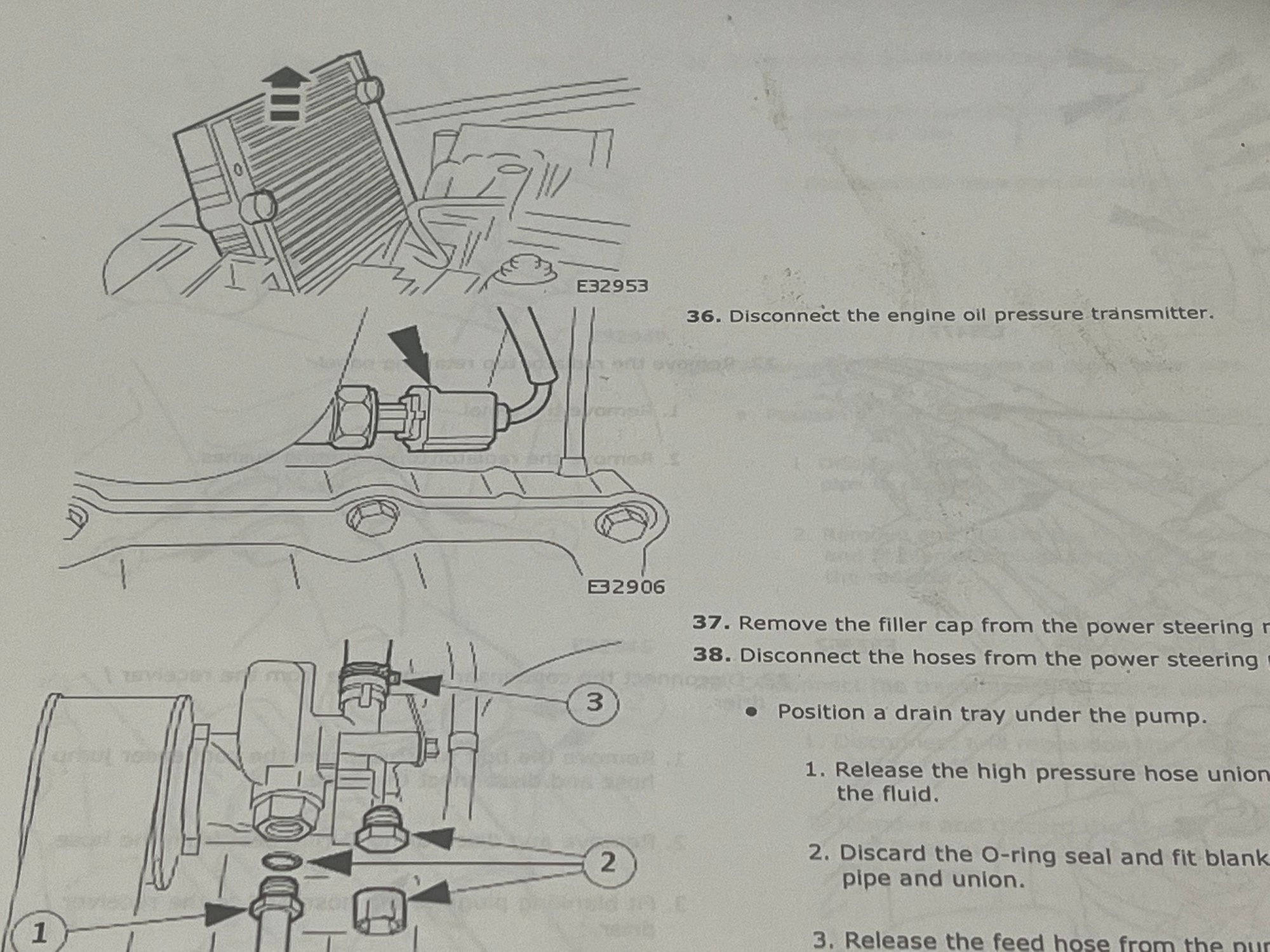

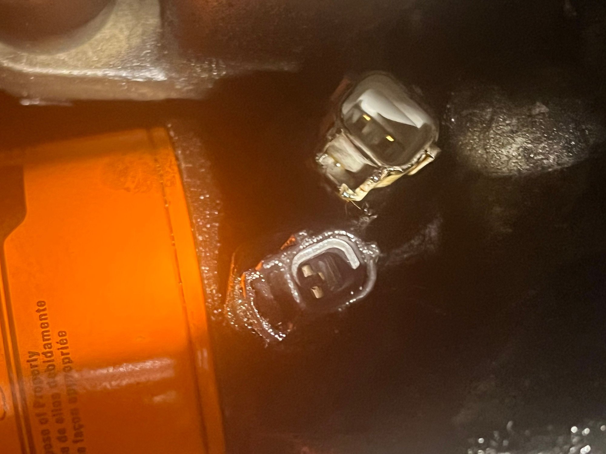

Pulling engine. Below is what the manual shows. Other pictures show my 2002 XJ8. Besides not in same area as in manual, there are two instead of one. Am I missing something?

manual is written from an aj26 car that doesn’t have it
one is a temp sender the other is a pressure switch
