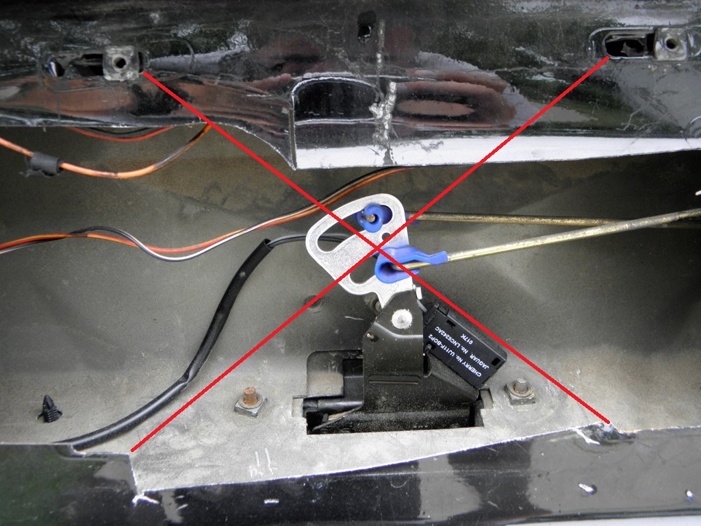

Lady Penelope's Avatar
Joined: Apr 2017
Posts: 4,039
Likes: 1,397
From: Kansas City USA
As an emergency tape a piece of paper on the sheet metal as you remove the plate . Mark an X as you use the plate hardware holes as reference points . Drill with large enough size for a screwdriver to lever over the main locking mechanism . The mechanism is robust enough that you won't harm it . There is a picture of someone going overboard and cutting a square but you can see the bunny . The bellcrank goes to the cars right direction to unlock . In the 3 layers of sheet metal on the pivot mechanism there is a 90 degree finger that must engage the locking hook that drops down below the picture into the car body receptical bar . This requires a larger hole if the finger is not engaging (as you have to put your finger around a corner ) but still small enough to hide behind the licence plate .
Hope this helps , Been there , Done that , Parker

It might work with something angled or bent, but based on where the catch is, I'm not sure a regular straight blade is going to be able to reach where it is towards the center of the trunk from one of the plate holes. That's why the DIY for the hole drill, is an inch or so left of center, to allow for direct access just off side of the catch (which works flawlessly btw, providing you have a thin enough screwdriver for the size hole you drill). I went through it a couple months ago after a cascade of stupid mistakes on my part left me with no choice.

A better pic with the X pattern as you can see the reference to the area of interest as you pull it over . I put my drill hole right on the X as you have to lever over quiet a bit and used a round shafted phillips screwdriver .

I was the one that "went overboard" by cutting a chunk out of my boot, though in my defense, it turned out that I had no option! A small nut had dropped into the mechanism, and no amount of drilling holes and pushing in screwdrivers worked, and would not have removed it. Here's what I had to do in the end:
https://www.jaguarforums.com/forum/x...rouble-168502/
I'm not suggesting you cut a hole the same as I had to, but like Lady Penelope's post, it shows the mechanism you're after. BTW, after welding a plate back in, and doing some grinding and filling, you can't tell there was ever a hole cut out!
