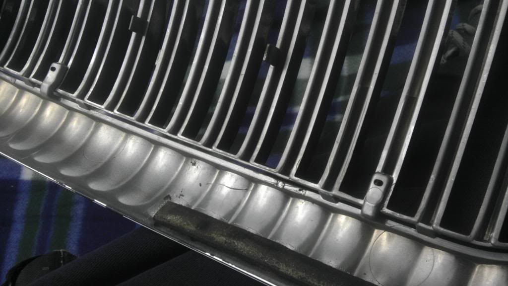

Below is what the grill looks like when it's off. Notice the screw holes on the left side of the grill. Those screw holes are what you need the T-30 bit for. Once you unscrew the screws, they may be dangling until all of the screws are undone and then the grill can be lifted off.

Next you want to find two screw drivers and something to wedge between the insert and the grill.
You have to get the screw driver wedged right between the insert and the grill and push up on the screw driver. Keep in mind that you might want to do this with both tabs on the same insert at the same time and get a wedge between the insert and the grill. If you try releasing one of the notches at a time, it puts a lot of stress on the grill, so get another person to help you with this if needed because if you crack the grill, you will be spending 5x more than you spent on the inserts to begin with. (These tabs are located towards the bottom of the grill.)

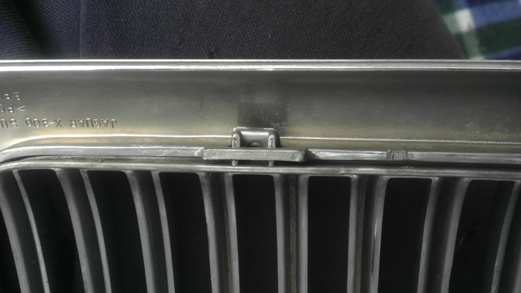

Below you will see there are tabs on the top of the grill that will need to be slightly bent away from the inserts in order for the old inserts to release upwards and out from grill. Remember to pull the old insert out from the back side of the grill.

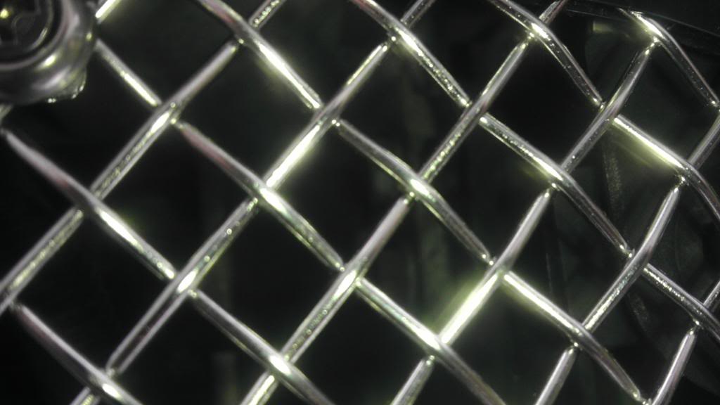

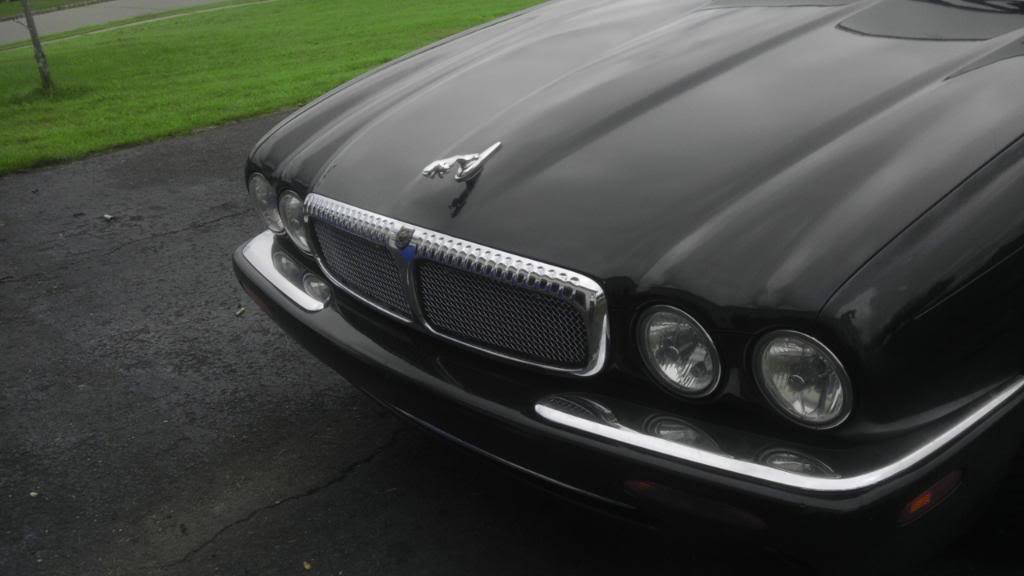

Now you're DONE!!! Check out the final product.....
Size:  75.2 KB Name:  IMAG0111.jpg
Size:  51.1 KB Name:  IMAG0112.jpg
Size:  55.4 KB Name:  IMAG0117.jpg
