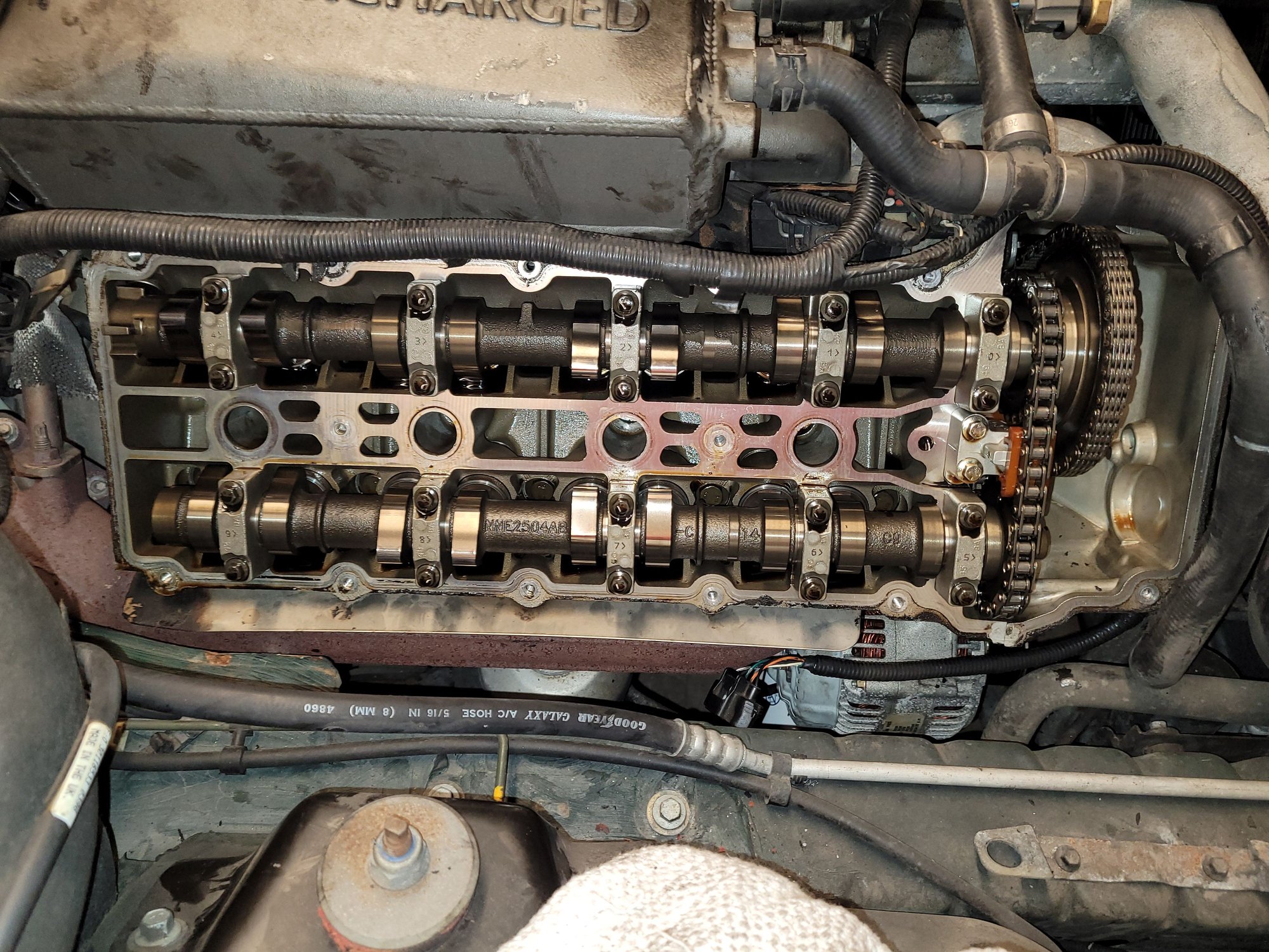

Or, take off a cam cover to be sure.

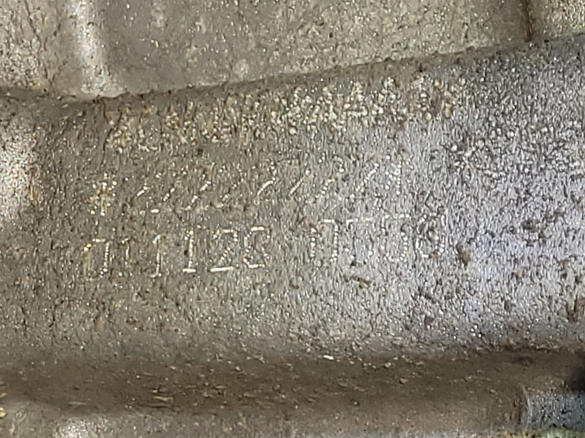

Hard to make out, but I beleive my engine sn is 011120XXXX and it has the morse chains.
