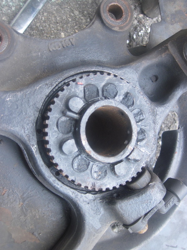

And then I get to this.... :9
I MEAN REALLY! Turns out I don't have a 2" 12 point socket...crap... any other suggestions on getting this off?
Need the part number to a new one, I need to replace it too now.
Wifes gone, I'm stuck without a way to get anywhere.. grrr
D'you know what - I'd not bother and get another vertical link/hub assembly from another car, looking at the ABS sensor ring almost all the lugs are smashed off. There's a couple of cars being parted out in the classified - obviously this'll take more time, but I'd just not bother with the original - my dog could've done a better job...

Aren't they known to shatter if someone is careless with them? Why not just deliberately shatter it with a chisel? Of course this presumes that the reluctor is being replaced with a new one.
BTW, is 2" the exact right size of socket for when someone else gets to this job?
Old Aug 17, 2012 | 06:04 PM
They come off with one of these and a lot of effort or they end up looking like yours.
Some butcher has discovered a hammer and chisel on the lugs doesn't work. Took a few lessons from the number that are broken!

Is one of "those" a special tool?

Anywhere to rent that tool? Or do I REALLY have to buy it.. ugh.. I hate retarded mechanics.
If I do have to buy it, it will probably be cheaper just to grab one from a part out.... and just take the bearing back...
