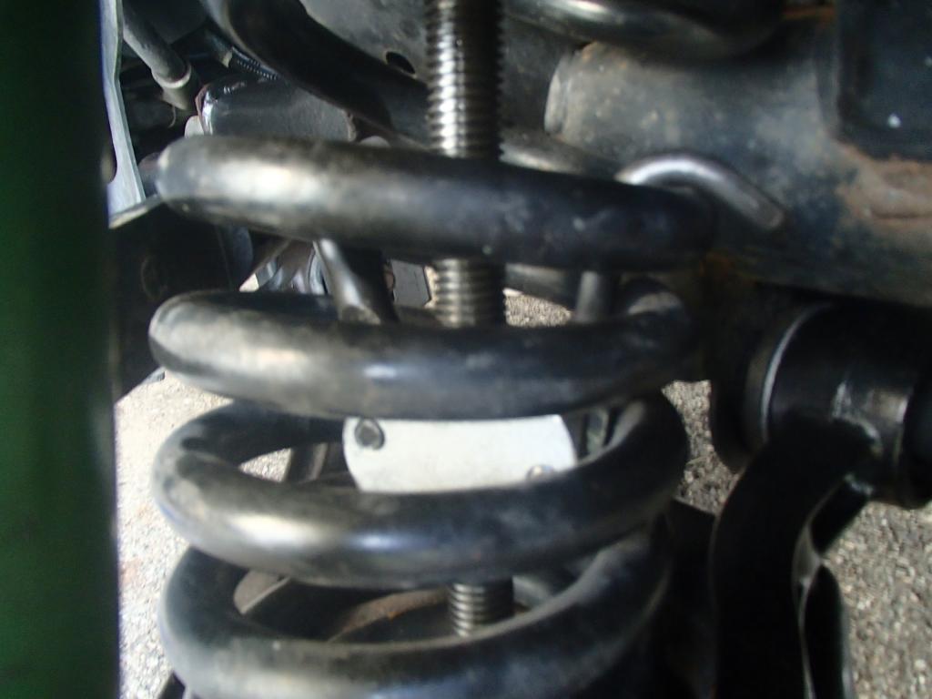

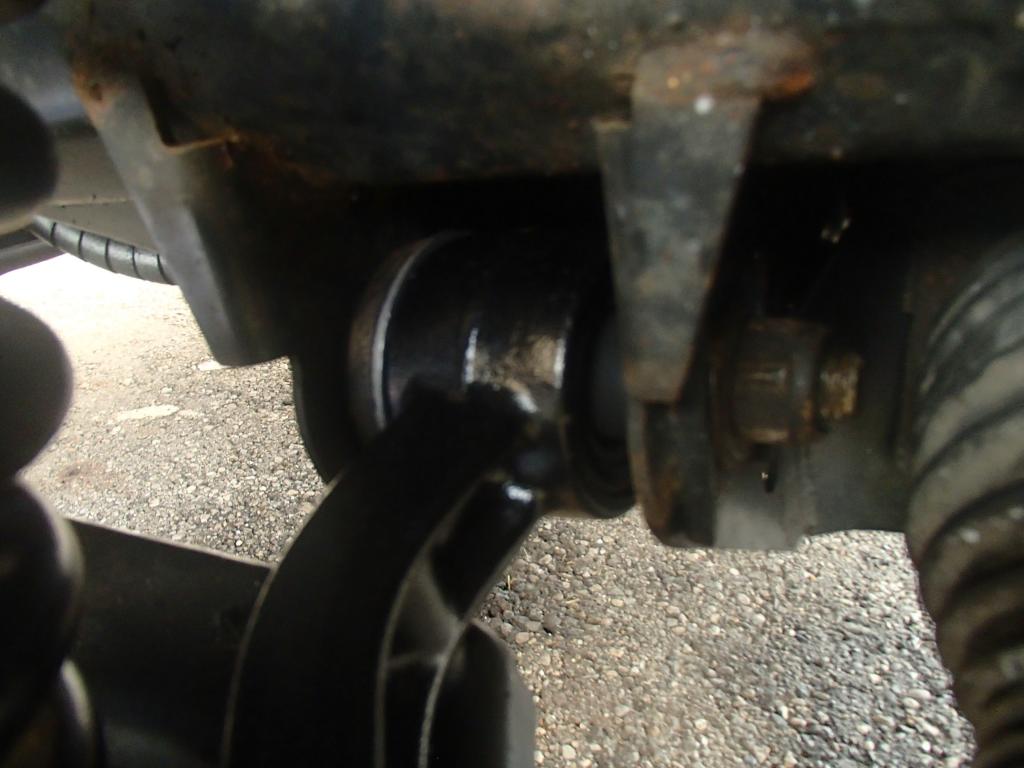

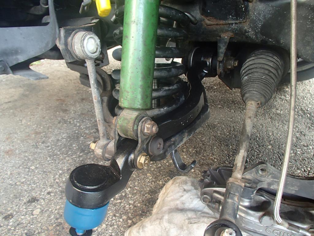

I made the coil spring tool from advance auto work forever.
All you have to do is notch the lower pan's center hole just a little wider to slide the center of this through... you can then bolt the hooks into it inside the spring... this tool will angle with the spring...
I added some thick washers to the bottom... Works like a charm for the rear arm install or new shocks... best of all you rent it and take it back
I also flipped the alinement bolts around since the factory worker put them in before the rack was installed... will be easier from here on out...
