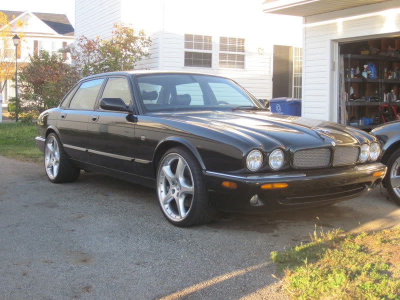

I liked the black trim around the lights as well as the windshield and rear glass so both went permanent with the honda black this week... it's 15 bucks a can haha.. but well worth it.
Please excuse the dirty car!! Got a new polisher and fixed a powerwasher so full correction write-up will be coming soon.

looking good, how would you feel about a lower mesh grille? I have one and I think it looks awesome.
I'm not sure how dedicated you are to the blacked out look, but I've always been curious about how black sprayed mesh would look...just a thought

Thanks for being the test car on this! I just orderd my honda black. did you prime prior to the Honda black? I would REALLY like to see you pull the front head lights and black out the chrome. IMO the mesh grille would "pop" even more than it does now...

to test blacking out the headlamp bezels wouldn't be difficult for test purposes, just run black electrical tape around them and take some before/after and different front end angle shots.
They're stainless along with the window surrounds so I'd suggest a good etch primer coat before using the Honda paint. The original Euro blackouts are powder coated.

The beauty of the paint is that it don't really need anything to work... but I scuffed everything with a scotch bite and it worked fine... I would also recommend a good cleaning with alcohol/water after.
The trick is to tape the rubber around the chrome in a way that it pulls it away from it. Then run tape around the edge lines, and proceed to do multiple light coats... I used a heat gun to cure it faster and sorta bake it on in between.
Ill probably test the headlights, you guys have me curious now
