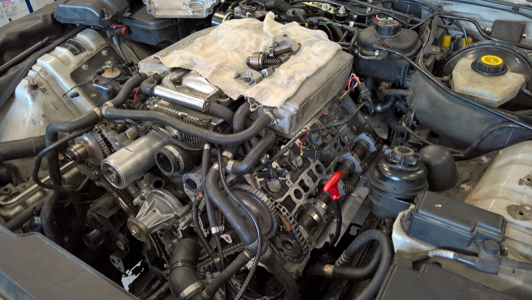

The second "first start" was made today. Unfortunately I was not able to be there, but they said: " Sounds pretty good! " . So, the proper AJ26 camshaft timing ring resolved the problem. Bad thing: I have to wait almost two weeks to see the car when come back from holidays. During this time they install lowered springs and stiffer shocks. Then 93/E85 flexfuel Jag is finally back.
The engine two days ago waiting for AJ26 timing ring to the driver side intake cam.
Attached Thumbnails My final project: 2016-jag_new_engine_1.jpg

Exciting, that is already a big milestone again, congrats so far!
How can you leave on holiday at this point in time baffles me though...
