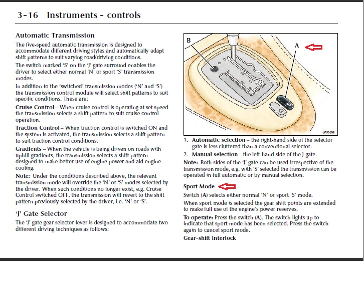

Hi
I listened to your audio recording and it might be related to the operation of the Transmission Torque Converter (maybe the flywheel).
Forum member Brutal mentions a way to test to see if the noise is coming from the Torque Converter:
"you might try the same quick test - do you hear this rumble, at the same road speed, in both the S mode and in the Regular mode?
wondering what might be causing the noise and what might be different between being in S vs regular mode - the torque converter lock-up in regular mode might be that difference.
Does the torque converter unlock in S mode at that speed? You can tell by driving until you hear the 'rumble' and slightly modulate the throttle, while watching the tachometer - if the tach moves with your throttle motion the converter is unlocked; if the tach only changes with road speed it is locked. Compare this between S mode and regular mode - I'll bet the converter is locked in regular (making the noise) and unlocked in S (not making the noise). "
I also created this JPEG file of XJ model Driver's Manual page that shows the Gear Shift modes Button that activates the Sport Mode (I added the red arrows in the text and diagram):
This test might lead you to what is causing the noise and if it is the Torque Converter, (if it is) then it still can be the transmission fluid level or it can be that the transmission needs to be removed to find and fix the problem.
