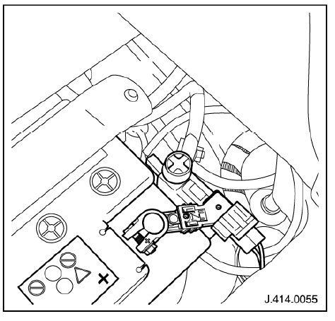

Name this mystery wire on my vdp? Thanks
Old Sep 15, 2012 | 02:13 PM
theusualsuspect's Avatar
Joined: Apr 2010
Posts: 189
Likes: 6
From: Arizona
Default Name this mystery wire on my vdp? Thanks
IM ASSUMING THIS SHOULD BE PLUGGED IN SOMEWHERE..LOCATED IN THE TRUNK. WHITE WIRE IN COLOR. HERE ARE SOME PICS...THANKS

It's been about 10 years since I did a PDI on the X308 but it looks like the transit relay wire.
NOT EVERY WIRE NEEDS TO BE PLUGGED INTO SOMETHING!
There are lots of connectors that go to options or devices required for other markets in the world. There are alot of things not installed on every car.
Tape it up and ignore it.
bob gauff

Here's what a Transit Relay looks like:
No owner ever sees one of these! The lead should be tucked away behind the carpet.
What is that sticker with the man running away from the open Luggage Compartment?

LOL thanks guys just wanted to make sure...ill tape it up and leave it alone lol
