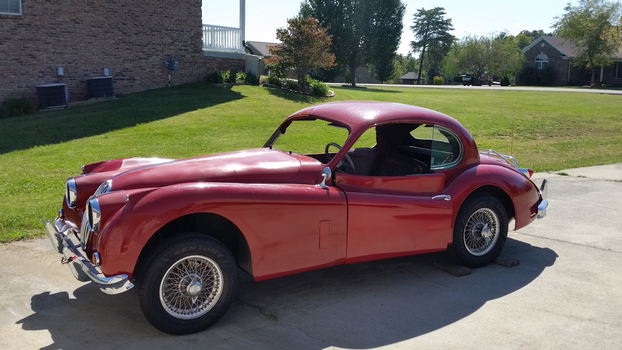

1) I have a complete rolling chassis 1956 XK140 FHC with no engine or trans;
2) I have an 03 XKR nearby at very good price (80K miles) - $1500 for engine/trans, all wiring harness, etc. (interior otherwise shot;
3) While it is a relatively simple conversion to use another Ford 302ci / 5L engine and autotrans, the sex appeal of putting in a Jag supercharged V8 is hard to emotionally overcome.
3) Question is, is it not only POSSIBLE, but is it EASY (!!) to transplant the XKR eng/trans into this bare rolling chassis? I DO NOT WANT ANOTHER 1+ years project!
- a corollary to this question is: Are there any recipes for doing this (being aware that there is a technical complexity of interacting sensors, black boxes, and strange electrical things going on with these modern Jags);
- Is there anyone out there who has done this sort of transplant (other than Beacham of New Zealand) who might be willing to offer tips, advice, etc.?
- Are there ways to block sensors or is there an aftermarket ECU to control the XKR engine and tranny (much like there are aftermarket CPU's for Ford Mod engines and the GM LS series)?

That little red XK140 coupe looks complete (less engine and box). Why not put an original XK engine back in there, it's crying out for a refurb/resto!!!
Any XK engine will do, the one I'd fit would be from a Series 3 XJ 4.2L - these had things like relief between the liners/bores to address cracks, big valve heads for performance and heavy duty connecting rods. The best of the XK Legend.

Sean,
1) You are absolutely correct - it's CRYING out for SOMEONE (someone else) to restore it or attempt to get closer back to originality! In fact, it used to be a show car! (see attached pic from its glory days)
BUT BUT BUT BUT -- it won't be me for a few reasons:
A) This car had a Ford 302ci with AT installed by the previous owner after the original engine "blew" -- engine has since been lost or whatever. So, the car is set up for a Ford 302ci with AT -- meaning minimal work to install another one, and certainly the Ford is a much much easier engine for me to get here in the States, PLUS anyone can work on it here in the States, etc. etc.
B) There have been some serious modifications made to the car already by the previous owner: It DOES have upgraded front disc brakes (rotors are vented); new modern dual master cylinder installed under the floorboards; new 2 1/2" dual exhausts; RonFrancis fusebox and wiring system installed (all new wires with their purpose imprinted on the wires(!)); Lokar automatic trans shifter installed; new chromed steering column installed with 15" steering wheel; installation of a custom-ordered rack and pinion steering from UniSteer, with power steering pump, reservoir and stainless braided lines; a full set of new "classic face" Stewart Warner gauges has been installed in the center dash piece; it WILL have AC (this is one of the few non-negotiable points, besides being an automatic transmission);
C) It MUST be back on the road, driving and licensed within THREE months. I keep saying this to myself to enforce it to myself: NO MORE years+++ projects!!! I already have 3 such projects that are probably 90-95% complete, and I am retired and can't quite seem to find enough time to finish any of them.
- YES, it will be a near-daily-driver, so reliability, service-ability, and comfort will be more important than looks or originality. (Shifting a manual transmission in stop and go traffic is only for 20 year olds.)
D) The things about the car that cry for a resto job are: new aluminum period-correct gas tank; the body is straight with no rust or cancers; all glass, trim, and most other parts are present and removed/stored in boxes (so a full paint job is much easier to perform); PERFECT chrome front and rear bumpers; all other chrome is in very good condition;
E) The things that just ring in incredible $$$$$, and which punt the idea of a restoration beyond reality are: an entire new interior is needed, including wood -- this is AT LEAST $9-10,000, includes the upholsterer's work; an in-line 6 Jag engine and trans would be AT LEAST $8-9000; a first-class paint job to be consistent with a near-original reconditioning would be on the order of $8-10,000. And then there are the sundries, which usually are not taken into account, but which often are major expenses of several thou dollars.
This adds up easily to $30K, even if I do much of the work myself. These cars are going for $40-50,000 per my recent research -- and likely LESS than that, because the final selling price of a car is seldom posted -- one can never assume that the asking price is the same as the selling price.
2) Yes, I am familiar with Broad's website -- I had bookmarked it a few months ago. It is great to have such a knowledgeable and specialized resource available.
3) HOWEVER, IF YOU WISH TO SAVE THIS CAR, I do have it up for sale until it goes for the engine transplant, with the firm intention of making $2000 above every penny that I have spent on it up to this point. IF seriously interested and you have figured a way to ship it to the UK, ping me a PM. Just remember, I know my bottom price and just making this into a daily driver is worth keeping it unless bottom price is met.
