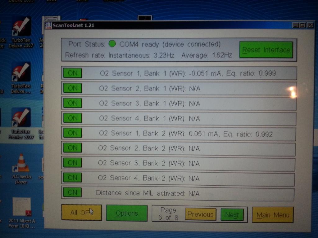

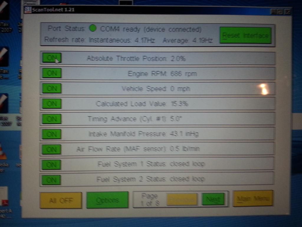

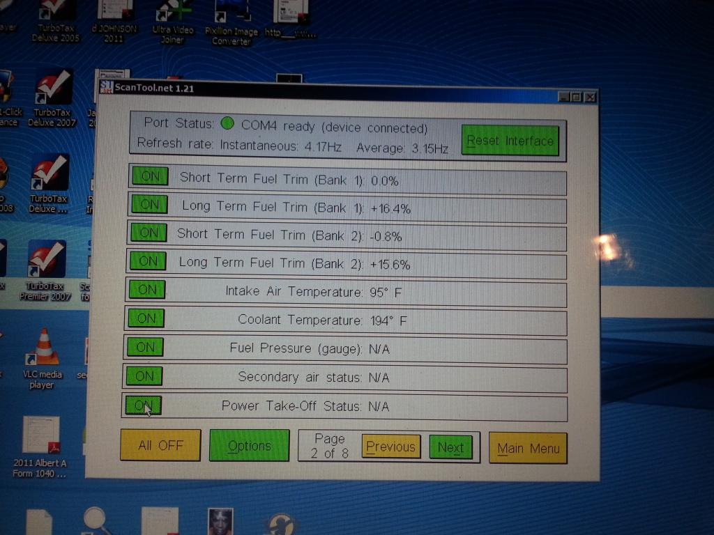

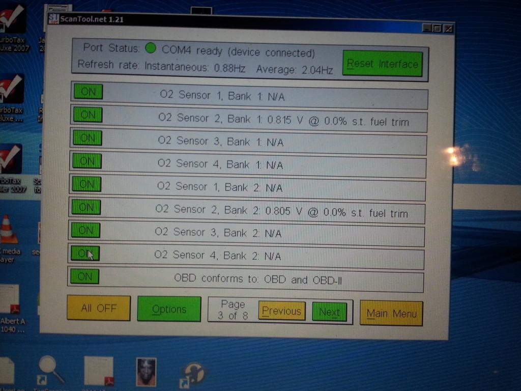

So I ran the code reader and I got code PO333 "Knock Censor 2 Circuit High"
And ran some test that were included with computer program
I need some help understanding what all this means.
I have a 02' XJ8, the test were ran after driving for 15 minutes
Attached Thumbnails Need Help with Codes and Test Results-20130223_162727.jpg   Need Help with Codes and Test Results-20130223_162804.jpg   Need Help with Codes and Test Results-20130223_162822.jpg   Need Help with Codes and Test Results-20130223_162839.jpg   Need Help with Codes and Test Results-20130223_162915.jpg

I tlooks like the knock sensor code is pending. You might want to just clear it and see if it comes back. Is the car running okay ? The long term fuel trims look high also. You might want to just check and see if you can find a vacuum leak anywhere and/or run some BG44K through it. It must not be bad enough to throw a code though.
