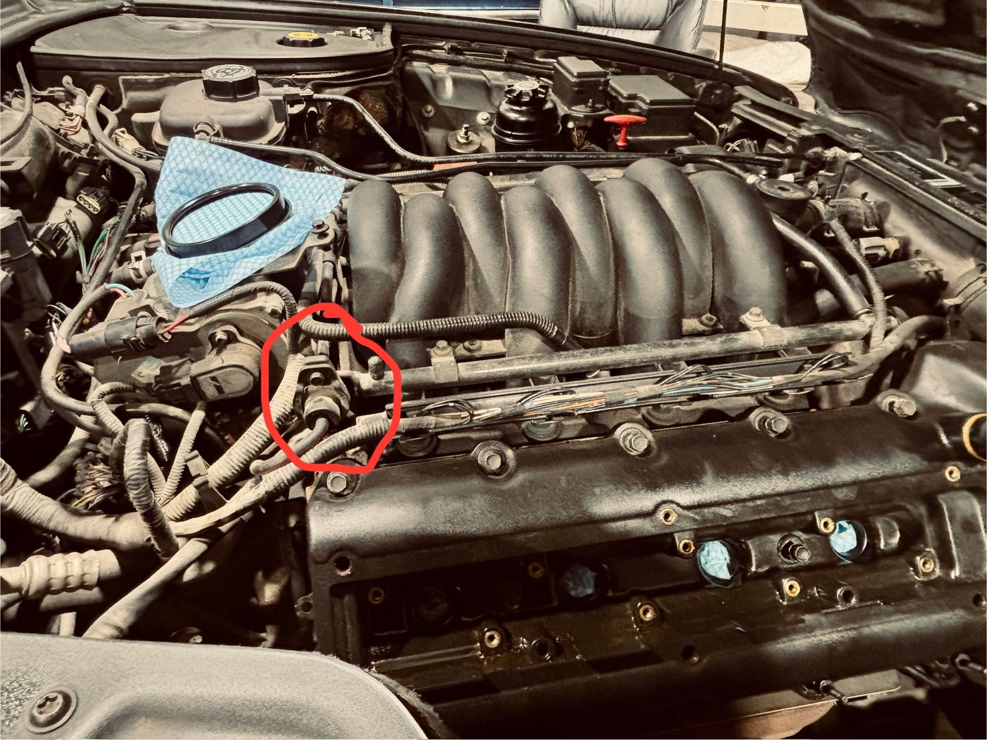

I discovered a fuel leak from here. What can cause this besides a bad gasket. Thanks.

I'd start with swapping the gasket (assuming that there is one) and go from there....
Don't drive, while the fuel is leaking... - or alternatively always take some sausages and long sticks along with you for a BBQ on the roadside...

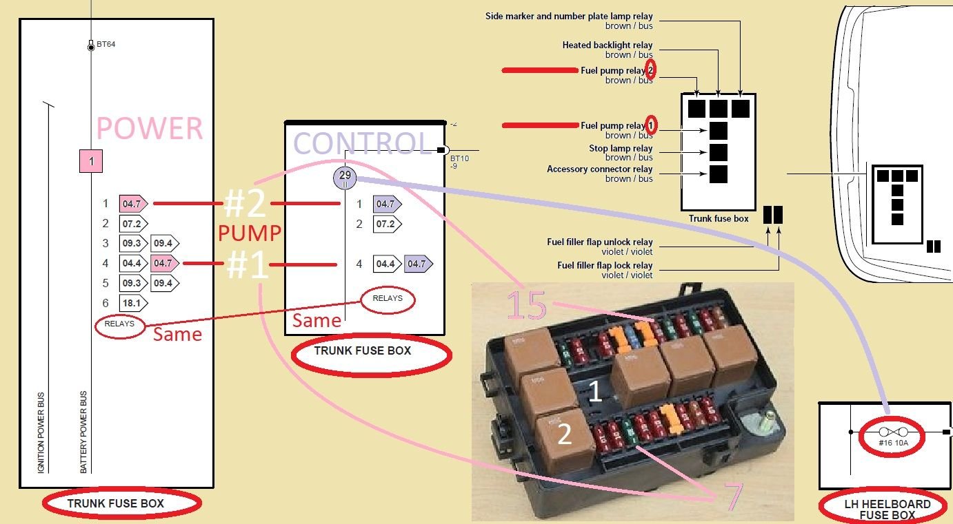

Fuel leak on top of any engine equals do not drive
Alot of early Jaguars suffered the fate of a smoking hole in ground
You can leak check it by jumpiring the hot at all times # 1 fuel pump relay and plenty of the cheapest kitty litter to keep fuel away from truck area or a hill
Pin 3 ( hot at all times ) to 5 ( to fuel pump )
Use medium gauge wire with blade type wire ends , the auto parts store can make one for you

Is it in the fuel pressure regulator?
