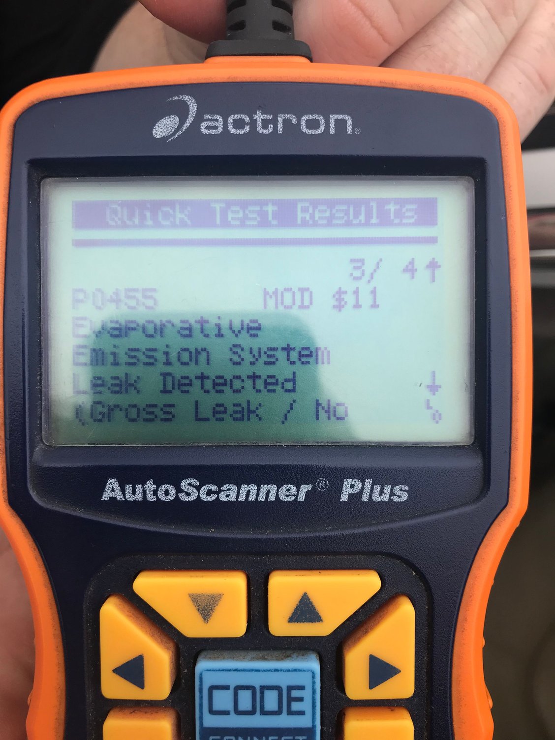

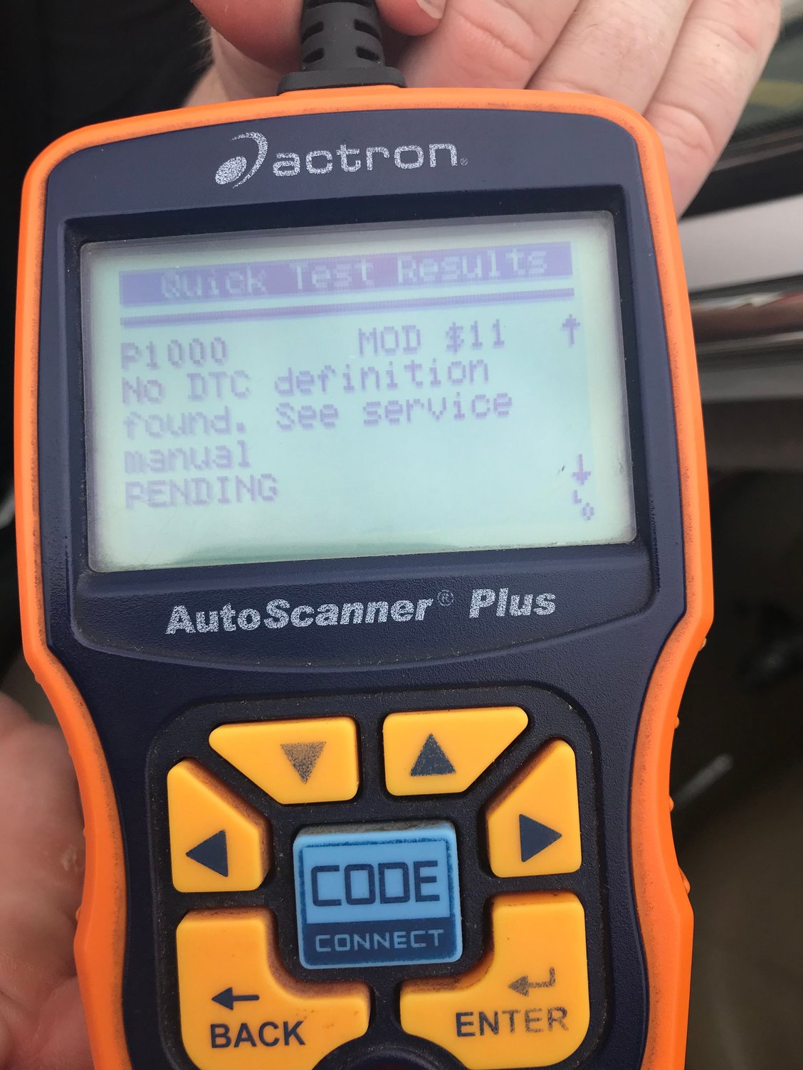

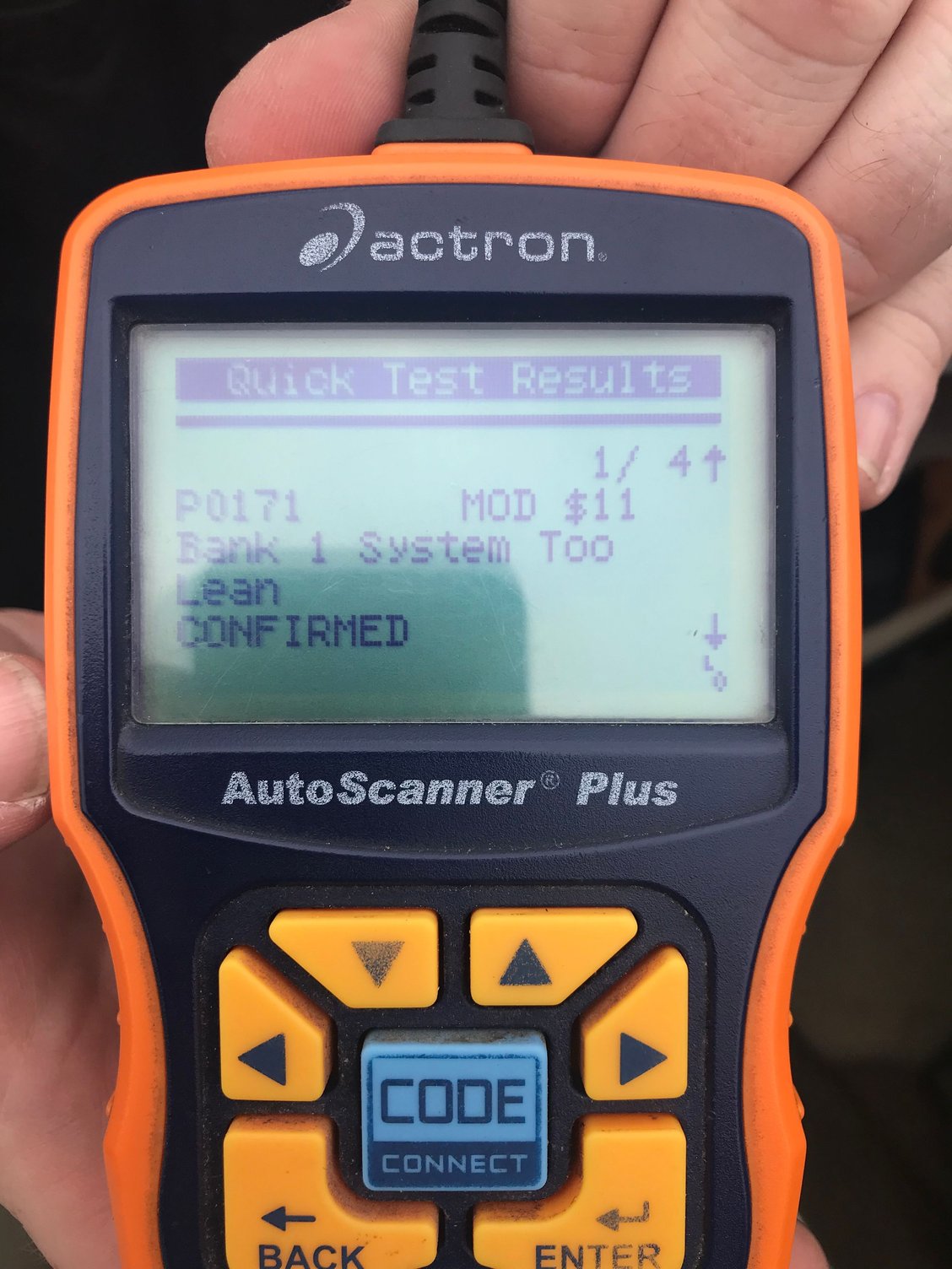

I went to my local Advance Auto Parts today to check what is causing my CEL to come on.
Here is what we found.

The first two being present usually lead to a vacuum leak, since both banks are showing, it could be something intake-related prior to the throttle body, or another vacuum line. Mine was a split in the hose leading from the TB to the brake booster in mine that caused those to throw. They're hard to track but it'll be somewhere. The 455 could be anything from the purge valve to the cannisters in the rear, lines in between, seals, connections, hard to say. Or could be a bad gas cap. 455s are hard to pinpoint. And the P1000 just means there's issues keeping it from giving the all clear.

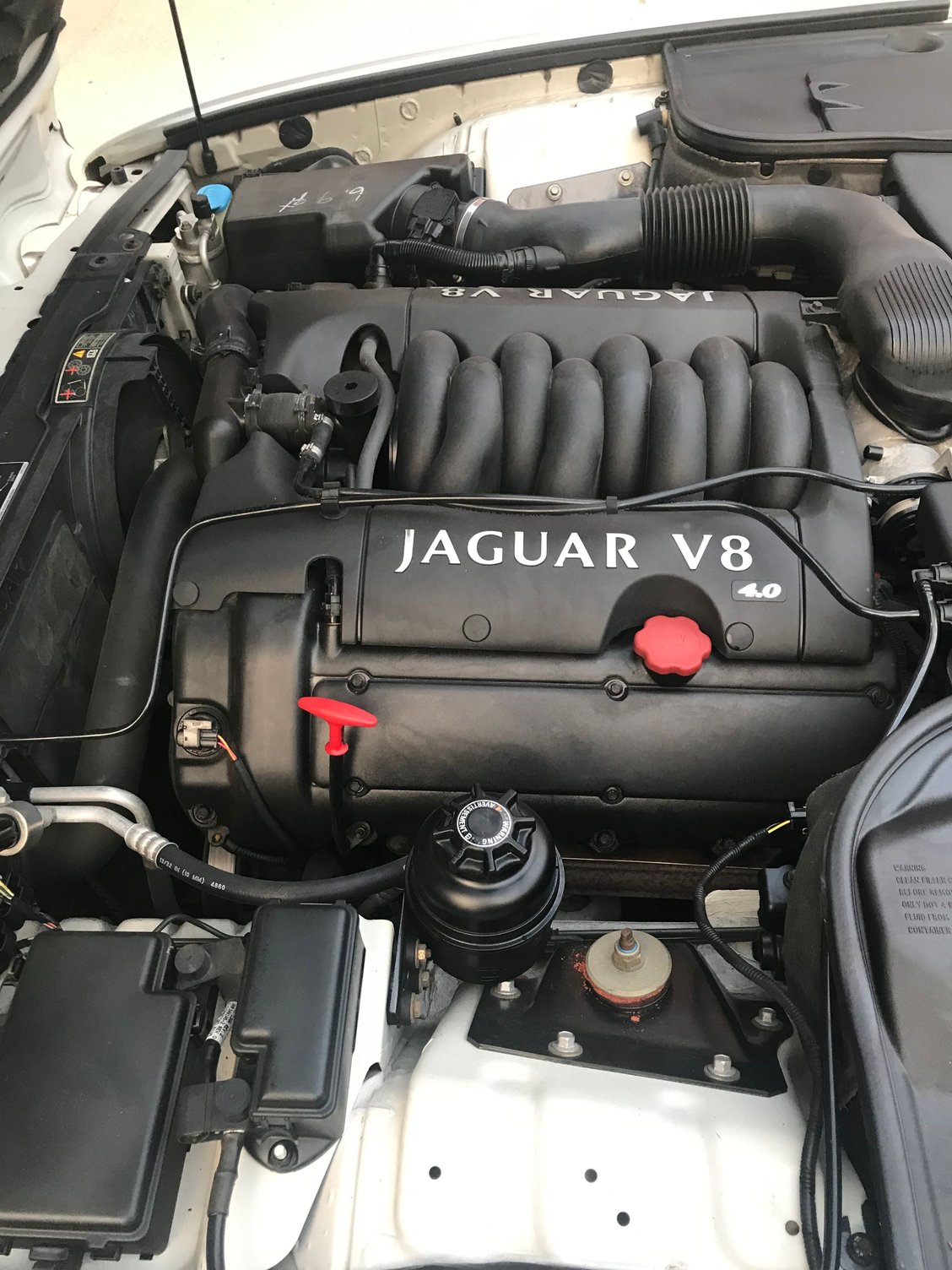

Under the center beauty cover near the cowl (between the coolant res cover and the tool tray cover) you will find the EVAP purge solenoid. It has on large hard plastic line that goes to the fuel tank. Look under the solenoid and see if its kinked or cracked. There is a vac line that goes from the solenoid to the throttle body just under the spring and see if the hose is split or leaking. There is also one more vac line that has a heat shield on it. I would bet one of those lines are leaking and its not properly controlling the solenoid to purge tank pressure into the intake. I just made a video for someone about this. After the repair is done you will want to reset the fuel trims. Easiest way is to unplug the battery for a few minutes.
Old Jul 18, 2019 | 06:33 PM
Okinana's Avatar
Joined: Jul 2019
Posts: 20
From: Southeast Iowa
LaserSVT
This is what I saw. No kinks, cracks or leaks.
Old Jul 18, 2019 | 06:49 PM
LaserSVT's Avatar
Joined: May 2012
Posts: 185
Likes: 105
From: Texas
The P1000 is just a readiness code. Means codes were reset and car hasnt been through 3 hot/cold cycles yet. The lean codes with the EVAP code would suggest the EVAP solenoid is staying open OR you have a vac leak in the engine bay somewhere and you need a new fuel cap. Oreillys has a fuel cap tester and can test the cap. Really its all just a guess without having the car on a proper scanner and reading the data in real time. See if the tank has pressure, see if the the EVAP solenoid isnt pulling the proper power, read where the car is comanding the TB to sit at. Hell your problem could be as easy as a dirty fuel filter, MAF and a bad gas cap.
