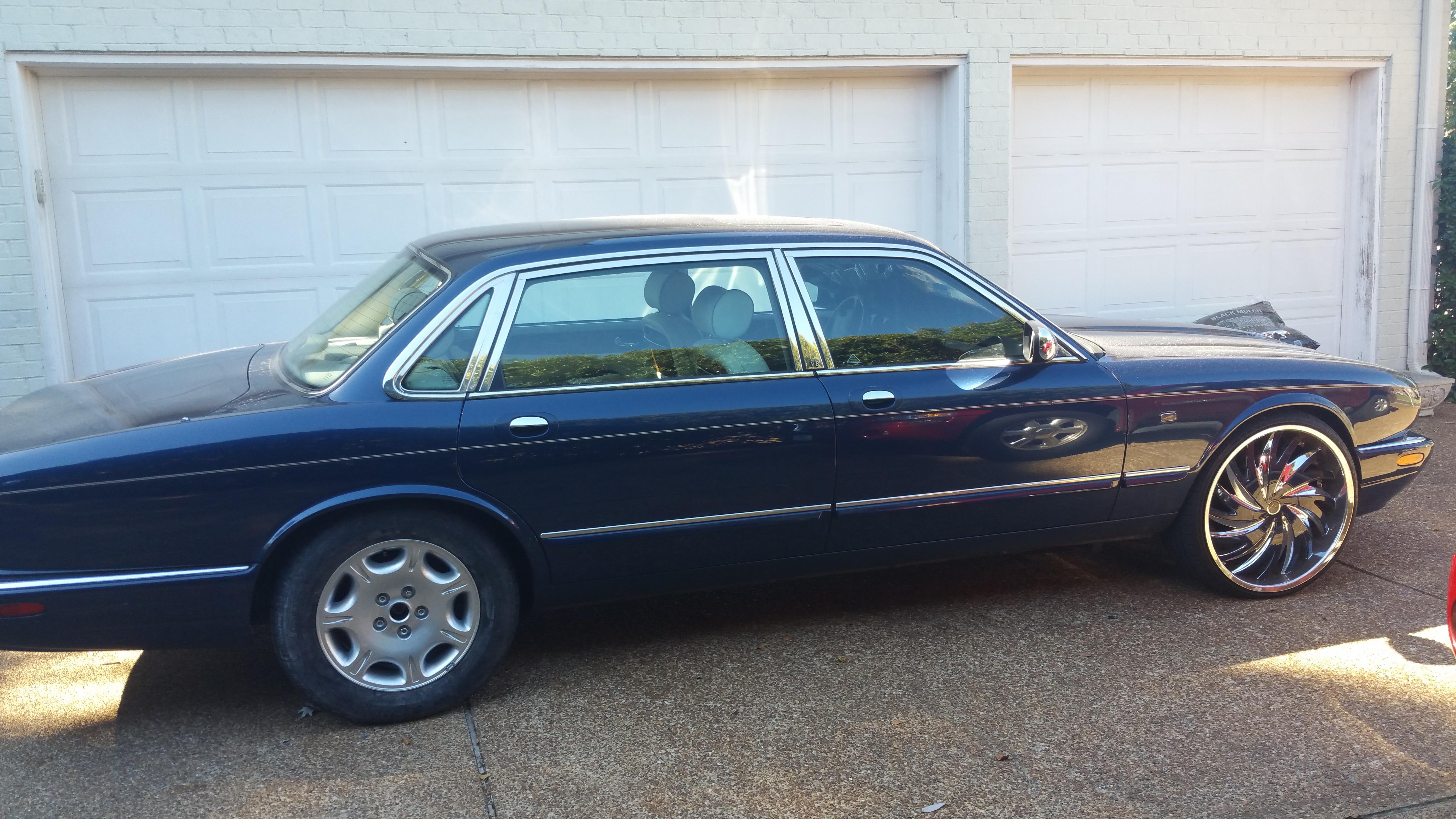

Perserverence.... maybe the upload will work this time. If it does, you will see a picture of my pride and joy...with the spare wheel (17") on the rear....
It did not work. I even went outside and tried taking a picture. After watching the picture upload via percentages... I get to 99%. Then poof. No picture.
My Jag is dark blue with 22" Status Hurricane rims... Chrome and blue that matches the car. I will look around the site for info on uploading pics.

I am attempting to upload the pictures here. One shows my car with the spare tire on. Tomorrow I plan on taking better pictures.

Those wheels are awful! I can see why you want them gone! Especially as on one side of the car they are rotating the wrong way.

R is radial, pretty much everything in passenger cars now.
18 is the rim "diameter" class, in inches. Yeah, yeah, not metric... but an 18-inch-class rim will have a standard tire mounting diameter, so the a tire designed for an 18 inch rim will mount on any 18, assuming the rim width (XJR factory is 18x8, so 8 inches wide for the standard rims) is within the functional range of the tire. Most will say what width rims they are compatible with. Most of the 255/40r18 tires ive seen specify 8.5 to 10 inch rim widths, so it's with a grain of salt...
There's more that goes into it, like bead shape, curb guards on tires, etc. that arent really important here.
So the diameter of the rim+ section width will be the tire outer diameter. The percentages were deviation from OEM outer diameter.
"designer type malarkey" Besides that I love that line... are you referring to the tires (Nexen) or the goofy wheels?
Which do you find problematic around potholes?
I have found those awful 22's to be so problematic I have parked my beautiful car until I can get reliable, sane (though stunning) wheels on it
