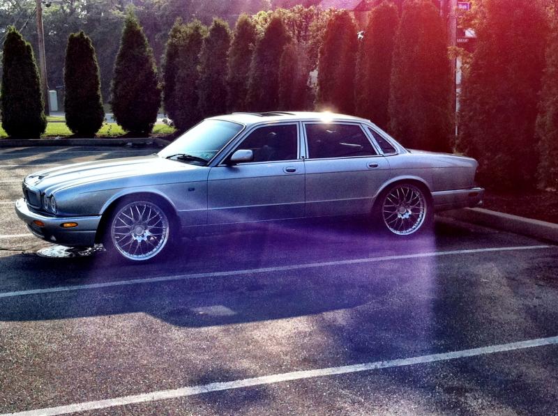

I got pictures to post!!!

Old Jul 23, 2011 | 09:16 AM
sh500's Avatar
Joined: Dec 2007
Posts: 68
Likes: 5
From: UK
Nice one thanks for that. I am thinking that I just need to lower the front, as I am guessing the deeper dish at the rear makes it sit just right anyway.

Hey , those wheels not shabby at all
