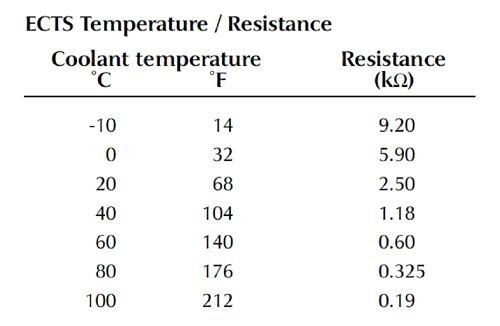

You said that your fuel rail pressure is about 50 psi which is a bit high and may cause rich condition. While the engine is running, the correct fuel pressures should be ~38 psi and should increase to ~44 psi when the vacuum hose to the pressure regulator disconnected. The pressure regulator vacuum hose is connected to the vacuum port on the supercharger, just below the coolant filler plug. Check whether the vacuum hose has, perhaps, detached from the port. If it is connected, you can use this connection point to test the fuel pressure when connected and when disconnected.
Another thing that can cause rich running, i.e. difficult start when hot, is a faulty coolant temperature sensor or its connector so have a look at this as well. The resistance values of the CPS should be as follows:

The car has an after market fuel pressure regulator, so i dialed that in. Thanks for the temp resistance chart. Its reading accurate through the obd but ill double check it. Im wondering if perhaps my charge intake temp sensor is faulty. I cant seem to find a pid for it on sdd or through torque. Any ideas? My only other thought is idle control through the throttle body is faulty? I notice that after I pull the fuel pump relays and get the car started, once I put the primary back in the car bogs for a second, then runs fine.
