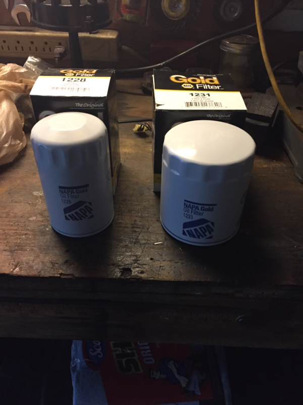

Stopped in NAPA to grab a filter for my 97 XJ6 and my XJR-100. The one on the right is for the 6 (4.0 liter, 7.5 qt capacity) the one on the left for the XJR (4.0 Liter, 7.9 qt capacity). My question is why would they think smaller/less filter surface area would be better? Or is it a case of less room = less filter? The big box store filters call for a smaller one for my V-12 and my XJ6 but NAPA sells the larger one for both, I figured they would have the bigger one for the V8 too.

Are they the same thread?
You should see the filter Bosch lists for the V8.
It ends about where the flutes start on the version
you have on the left.
They are trying to cover the 4.0/4.2 with one part
number. The 4.2 does not have room for the longer
filter.
Porsche 911's have the same thread as the V8 filter,
and up to about a foot long.
Won't ever fit the V8 because of the placement next to the
frame rail.

To add to this, it depends on how many filter levels they packed into the can also. Do they have a micron per fluid amount listing?

What i could find on line says its special "mesh" traps 50% more then most filters. The threads and gasket seem the same on both so I may give the one on the right a whirl on the XJR to see if it'll fit. I couldn't believe how small purolator went with their replacement filter for the 5.3. I use the NAPA 1231 for it and the XJ6 ( and just maybe the XJR)

Originally Posted by JTsmks
... so I may give the one on the right a whirl on the XJR to see if it'll fit.
Please do, and please let us know
The interference point may be the stubs of the oil temperature and oil pressure
sensors.
Don't forget that the gasket on each has to be the same
inner and outer diameter within reason.
