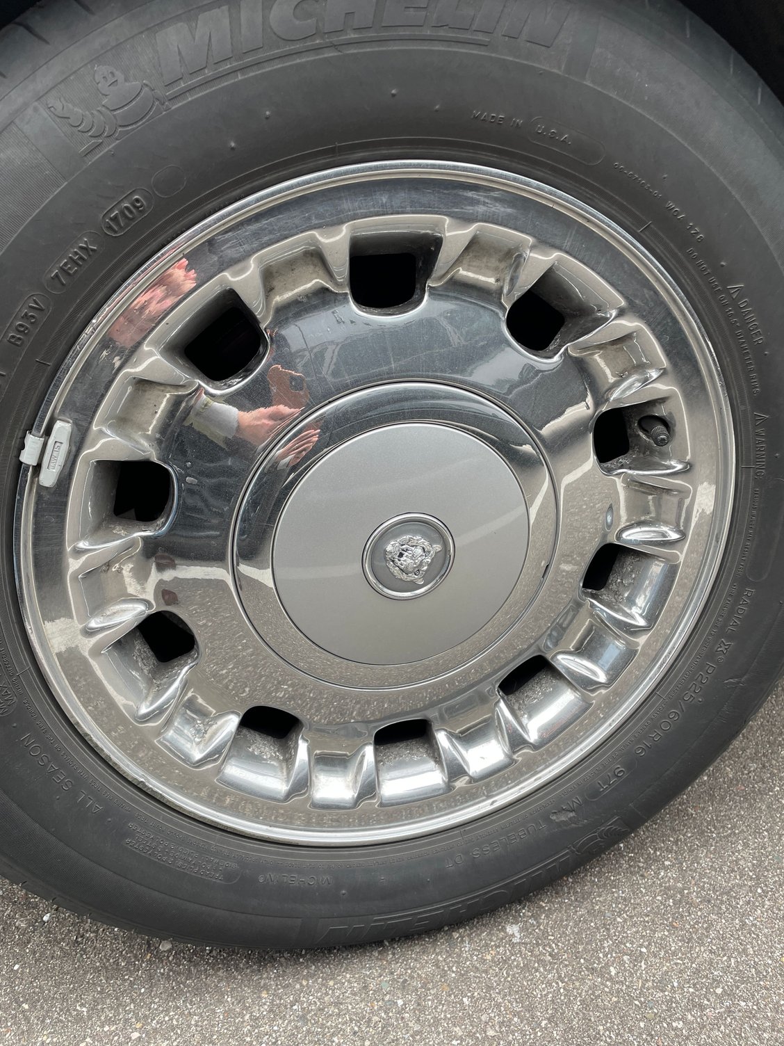

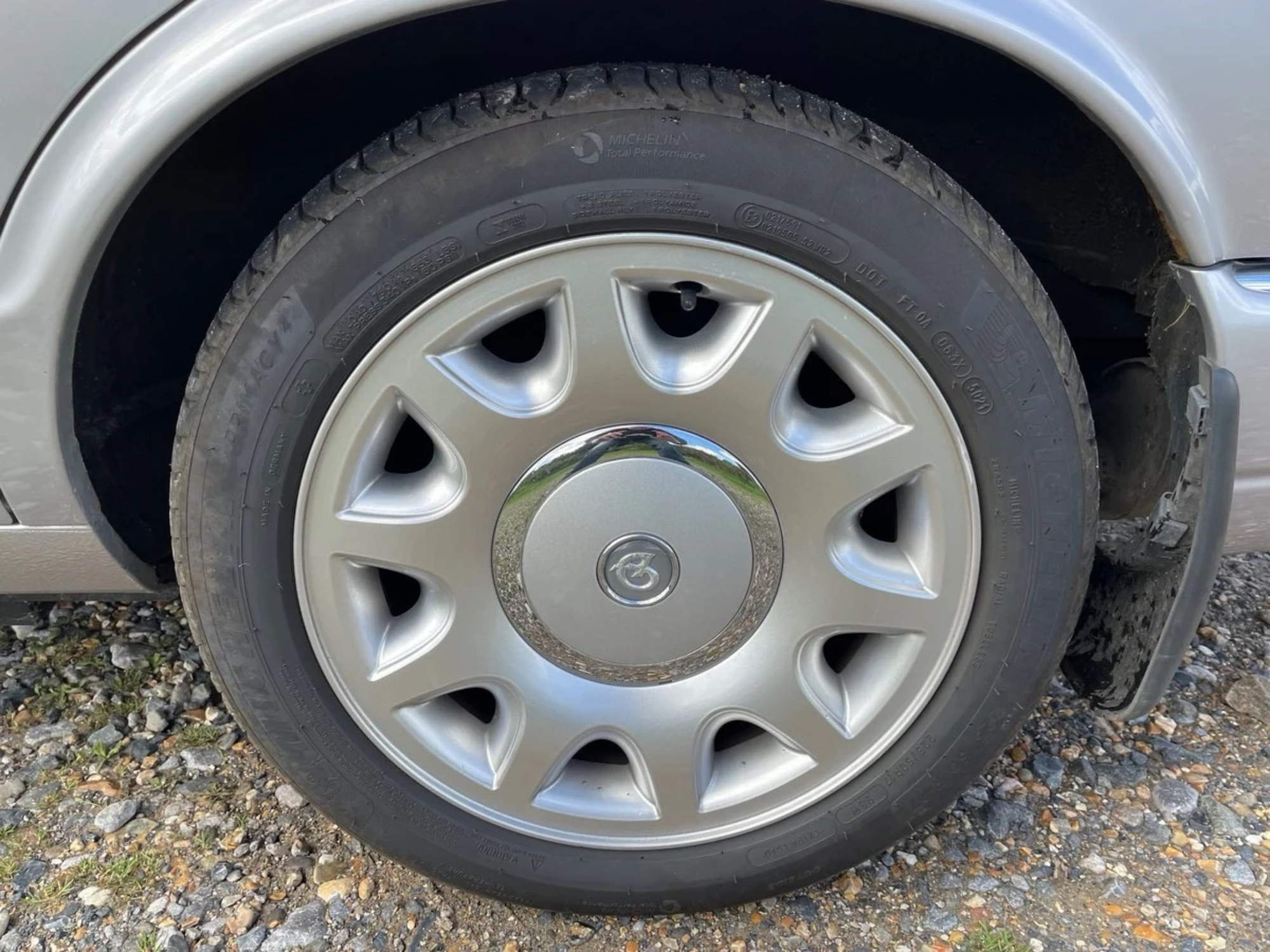

Hey folks,
I currently have these 16" rims on my 98 XJ8 VDP (225/60/16 tire size). The chrome on the front rims is peeling badly and causing slow air leaks. Looking for recs on any other time period-appropriate OEM replacements rims that would be 1:1 compatible.
I'm seeing these on FB Marketplace, and wondering if they would be a compatible swap?

STARBURST are the most common and will fit all but the XJR with big brakes.

I think the wheels you have, when refurbished correctly would be very stylish.
They were never meant to be chromed.
Get that taken off and powdered coated the same shade as the hub cab and they look a million dollars!

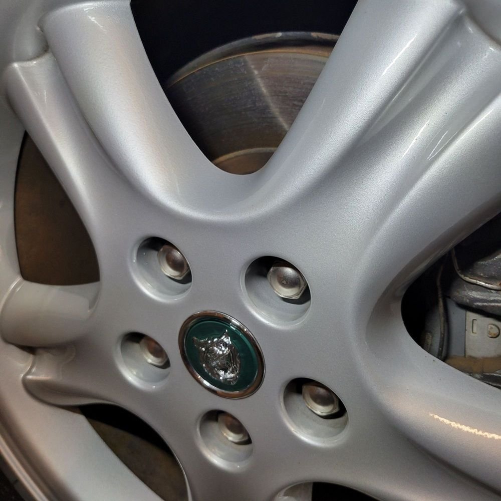

This is a very similar style off of my Super V8.
