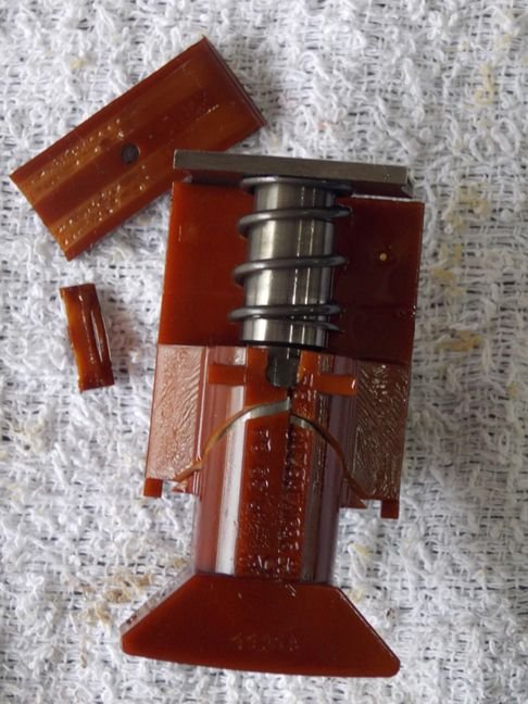

Doesn't sound good, I think it's time to take a valve cover off and peak inside.
If you find you still have the original orange timing chain tensioners, replacement of the primary and secondary tensioners with MKIII metal type are due.

Age has as much to do with deterioration as mileage, here are my tensioners at 69,000 miles and 17 years of age.
You have probably jumped one tooth on the cam gears, if it jumps one more it will basically destroy your engine. You would be well advised not to run the engine again and fit new tensioners/chains etc. immediately.

just open the valve covers and see what’s up. secondaries guaranteed to be cracked or your money back, primaries are a waste of time unless your guides have literally fallen to the bottom of the oil pan.

Primaries can go bad too and not to mention chains stretch over time. I've pulled primaries out that were cracked all the way down the middle and they have plastic oil tensioners too. If those tensioners no longer pressurize then you have both chains loose. Just replace them all and not worry about it for another 100K.
