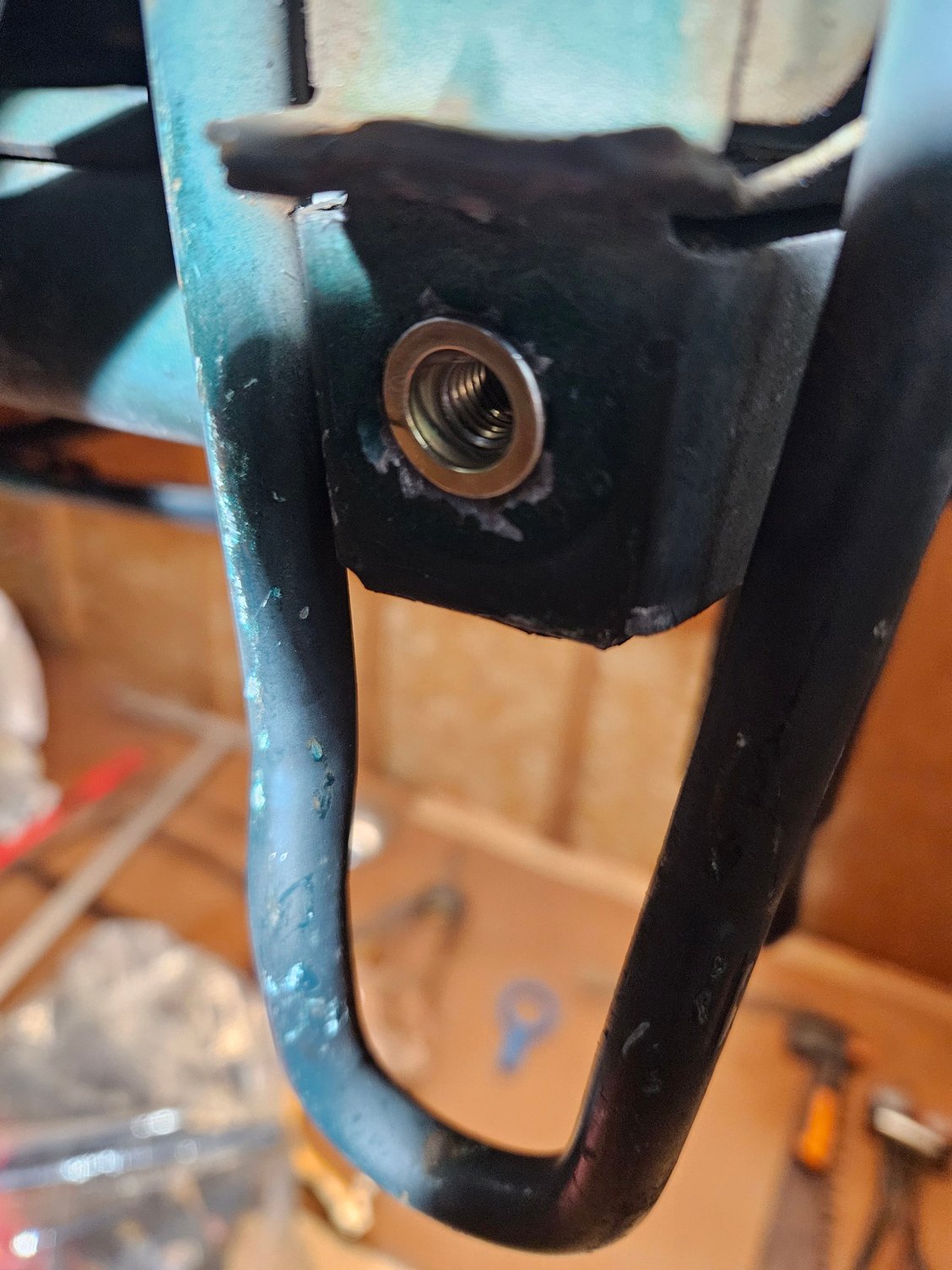

Very impressed. Rivnut with the OEM M8 threads. Had to ream the hole out a bit and its a nice snug fit. I'll pick up a pair of new bolts tomorrow so they use the same tool and I just need to collect my repaired oil cooler on Monday and reinstall.
