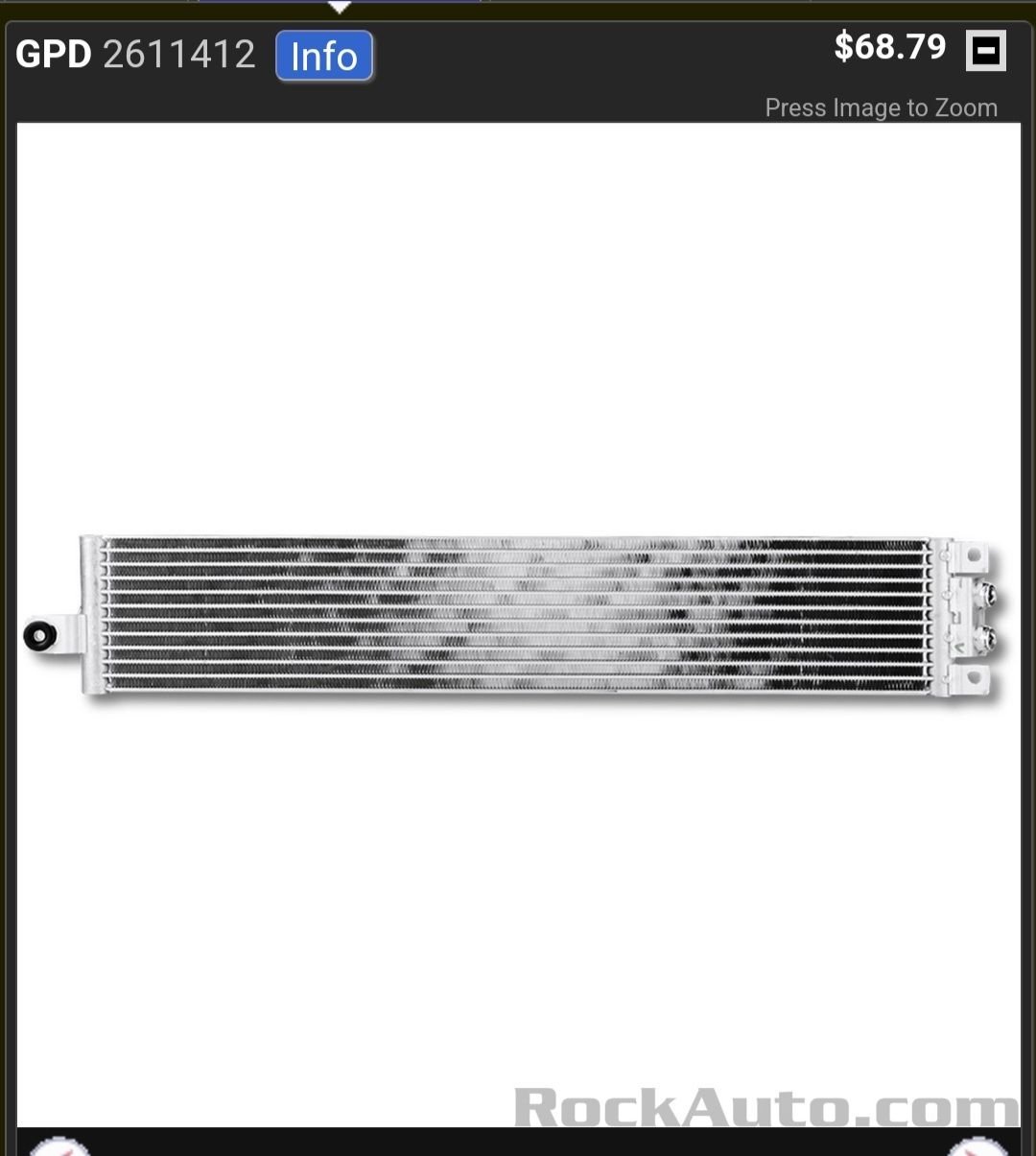

Check this cooler and for the hoses get transmission hose and cut the thread if it's bad use fuel clamps the regular clamps will cause leak because doesn't tight it circularly but like egg shape which cause leaks , find correct thread aluminum barb hose adapter size it's easy but you need to get the correct parts and having patience
Nice find! Thank you!
I will say that I’m a bit concerned about the core depth of .71” being a little anemic. I know that somewhere is an oil flow diagram of the S/C engine with the oil thermostat and cooler. I just want to make sure there’s no starvation upon re-entering the engine.
