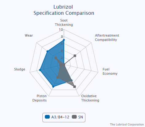

When API SJ and ACEA A3 are compared, the A3 would
be the hands down winner.
European readers will know this well.

ACEA A3 is the more stringent oil specification. This offers
superior characteristics in areas that truly address engine
protection as compared to other considerations such as
CAFE fuel averages and getting cars out of the showroom.
Given the choice between ACEA A3 and API SJ or even SN,
it should be a no brainer.

Membership aside, the ACEA A3 sequence is of value in defining oil quality.
For example, knowing an oil is ACEA A3 compliant means that HTHS is >= 3.5 cSt.
There are a multitude of engine performance tests that the vendor is deemed
to have satisfied by virtue of claiming ACEA A3 compliance.
Given a choice between ACEA A3 and some oil that was not, the former would
be a better choice on purely technical considerations.

Wandering around second guessing myself, I found the following
graphic from Lubrizol. It is their take on the relative strengths
of two mythical ACEA A3/B4 and API SN compliant oils.
The further a point lies from the center, the better the value.
As you can see, the ACEA A3/B4 appears to be superior in
predicted performance in most parameters.
BTW, the reason some ACEA A3/B4 oils cannot meet API SN
is that there are higher concentrations of some anti-wear
additives than allowed by API SN that are permitted or
called for in ACEA A3/B4.
pps. if you don't already know, Lubrizol is one of the big
three producers of the additive packs used in producing
engine oil.

Is the chart not speaking to "fuel economy"? Or, are the two oils essentially the same? Why would SN rating "not allow" wear components (assuming they were good things)?
BTW, even if you did not mean to characterize AC3 oil as "best" that sure is how the original post came off!
